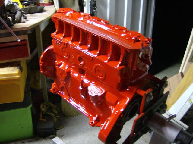

One to the new engine...after spending hours polishing the block and head I wanted to make sure the paint was going to last. POR to the rescue again. I cleaned all the parts a dozen times and they were about as clean as it gets. This took a full day - not kidding. Then they were acid etched with the POR metal prep and given a coat of POR-15 sprayed right from the tin. It sprays very well - nice shiney black.
Then after it flashed off - I top coated it with POR engine enamel. This stuff is so thick it can't be sprayed...had to thin it with laquer thinner. Then it would come out of the gun! While the regular POR flashes in a couple of hours, the engine enamel takes 24 hours to recoat :shock: It was still tacky after a full day of drying. On with the second coat - even better. The gloss is crazy - couldn't take a proper shot of the engine with the flash on my camera, but it will take a couple of days before I can roll it outside to take some decent shots.
The paint had better hold up - I'm not planning on doing this again! Since the block and head were polished, the resulting paint is very smooth and shiney.

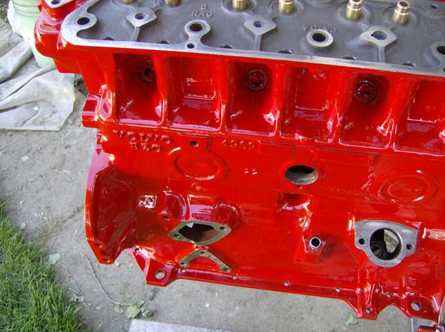

PostPosted: Tue Jun 17, 2008 5:12 pm
Here are some shots of the engine unmasked and outside...looks much better.
PostPosted: Tue Jun 17, 2008 5:37 pm
purrrrdy
PostPosted: Tue Jun 17, 2008 6:33 pm
You are going to be sooooo pissed off when you scratch it for the first time... :lol:
Looking beautiful. Wish I had that kind of patience...
PostPosted: Tue Jun 17, 2008 6:49 pm
Sort of hoping that the POR engine enamel is as hard and durable as the regular stuff.
