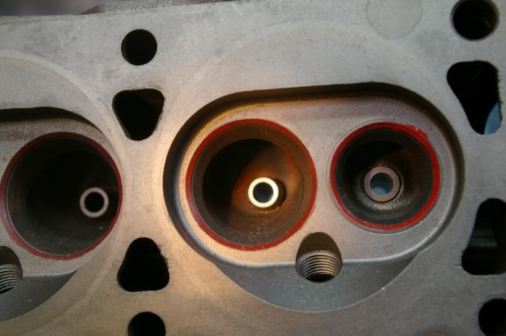

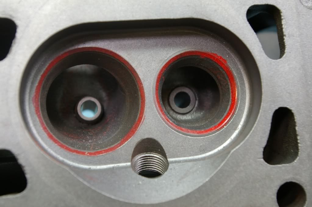

I'm going to put this post in here because that's where I think it belongs. I finally got Greg's port work done this weekend. It took me quite a bit longer to do the B20 than my previous B18 work as the casting is much harder (or my bits have gotten duller). I decided to try to capture a few things photographically and measured a few more things to get a sense of the numbers. I'll post the numbers later.
So here we are again at the start - we all know about the valve restriction in these heads - here's how I've captured it digitally. The red lines are my "idiot" lines for porting and keep me away from the seat area.

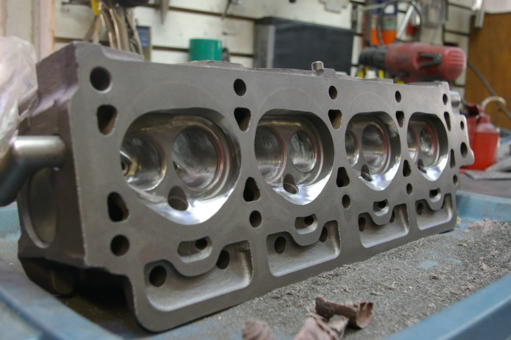

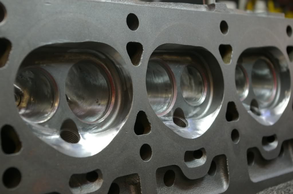

Face on - sure looks like the normal shot.

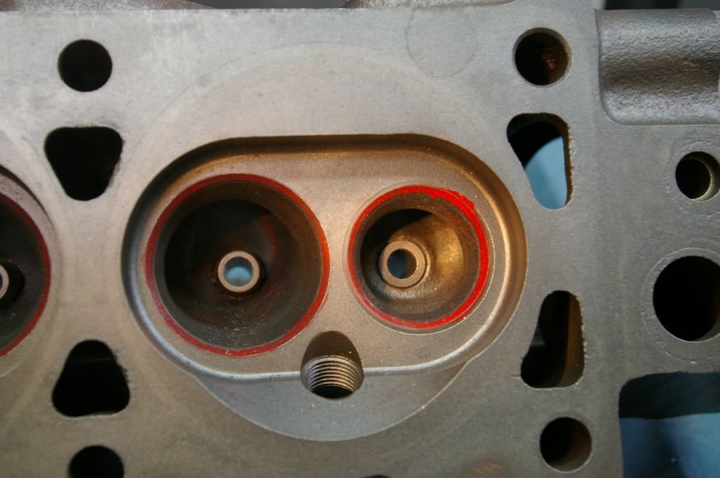

Lets light it a little differently.

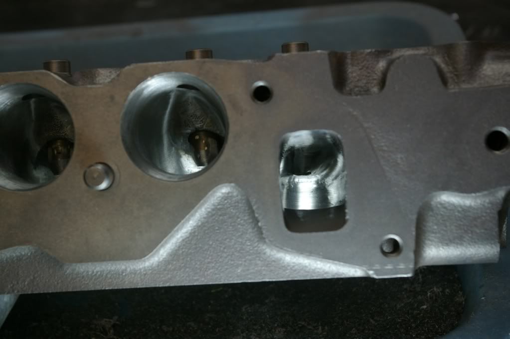

Inside the intake - some attempt has been made to help flow around the valve.
About 6.5 hours of porting later we have this...

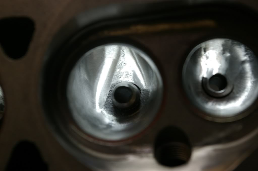

I've preserved the port bias and tried to improve things in the intake and exhaust tract. Here you can see how I've opened up the area behind the valve almost to the valve seat.
I've tried to direct the flow a little more forcefully around the intake valve and have done what I can with the exhaust (while preserving it's bias).
Finish on the intakes was left coarse - the exhausts were fine finished, but not polished.

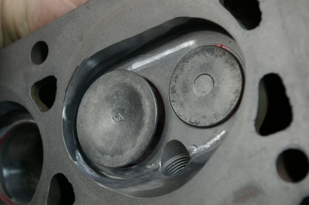

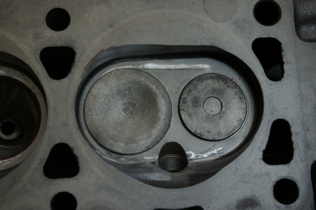

Combustion chamber alteration - I've tried to unshroud the intake vertically here a little and clean up the ramps into the spark plug area.
I've not gone too far - but this is a little further than my B20 head. The good news is that nothing else on Greg's car will change - only the head. So we'll see how things get better as a result of improved compression and the port work.

A few numbers - while I'm only quoting areas and not volumes, I thought it would be interesting to take a few measurements of the ports. I used my T-gauges to find the maximum diameter of the smallest opening of the port. While the shape of the port restriction is not always circular - it is an approximation. The T-guage was then run through the other ports to ensure that no smaller port maxima could be found.
Stock B20:
Exhaust port max restriction size: 26.3 mm
Valve seat size: 34mm
Intake port max restriction size: 33.8 mm
Valve seat size: 43.11 mm
So we can see right off the bat that the ports have between 8 and 10 mm worth of narrowing right after the seat.
Ported Head - lets call this a Coburn Performance Stage 2 head:
Exhaust port max restriction size: 29.36 mm
Intake port max restriction size: 37.3 mm
Running the numbers on the area difference, the port work that I did on this head resulted in a 23.77% gain in port area behind the exhaust valve and 21.78% gain in port area for the intake valve. The rest is all about the shapes that have been created. Either way you slice it, that's pretty crazy.
The tough part is explaining what is going on behind the scenes in the runner area as I'm trying to direct flow to certain parts of the cylinder. For example, I have enhanced the port flow around the valve and done so to increase flow to the outside in the hopes that this will create more tumble of the fuel charge on the intake side. On the exhaust side, I have left in what has been cast instead of trying to fix what is not possible (the short side radius is improved as much as it can be, but the port floor is left completely untouched) and I've biased the port towards the roof of the port. This is in an attempt to provide volume and velocity to the exit charge and to direct it up off the area where it will eventually get worse due to increasing cross sectional area. You do what you can with this area.
