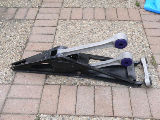

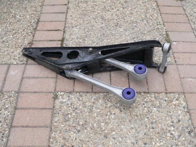

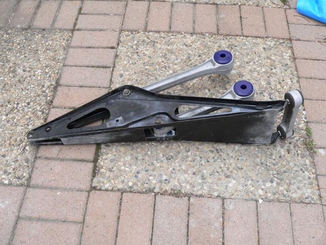

Not to thread-jack but I am doing the same upgrade.
I have had the urethane bushings for a while, subframe stiffening performed by the master hands of Matt D (THANKS MATT :supz: )
Although you will notice I didn't take any close-up pictures of the welds LOL
