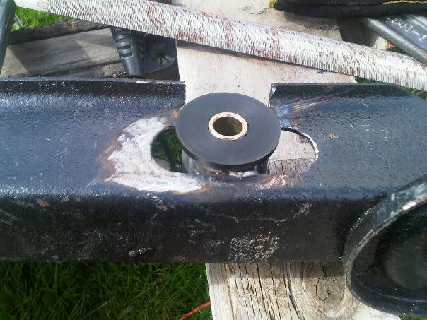

ordered bushings today, so my trailing arm design is finalized. new pucks are here for jigging the rear end properly. The only catch now is i've gotta fill that 1/8" gap that is left behind from the saw blade. So, i should have a rear axle mounted this weekend.

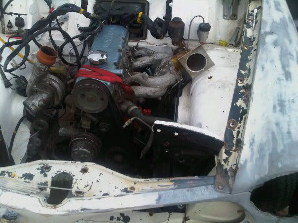

Also, i've decided to remount the engine, probably a half inch higher or so than it was, that will give me all the clearance i need. I'll hang it between the frame rails like the PV. I may need to clearance the d/s tunnel though.

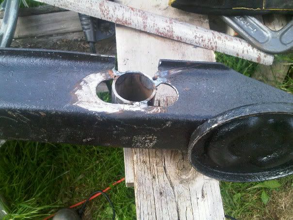

sweet. got the rear end cut down again, one of them right through my old weld... looks solid! i wish i had a digicam instead of the blackberry or else i'd be able to take a good picture.

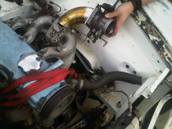

couldn't get any DOM pipe for my mounts yet, so i started running a wiring harness and building my intake....
PostPosted: Mon Sep 06, 2010 9:06 pm
Are you JB welding that mandrel in there?
PostPosted: Mon Sep 06, 2010 10:06 pm
Brazing with oxyfuel. I also am going to make some bolt-on bracing too as it is going to have some nasty vibrational stresses.
PostPosted: Mon Sep 06, 2010 10:36 pm
Why not get an aluminum mandrel and weld it properly...I can't see brazing working very well.
PostPosted: Mon Sep 06, 2010 11:36 pm
Mostly lack of skill. This is an interim thing until I learn tig welding. Plus, the bov flanges and stuff I've done like this have held awesomely. As well as the end tank on the kenworth ic.

I spy a V8 Mercedes throttle body?
PostPosted: Tue Sep 07, 2010 7:14 am
Looks a bit BMW'ish to me...
PostPosted: Tue Sep 07, 2010 9:30 am
82' 733CSI ;)
also, 17x12x3" w/ 3" in/out i/c, 3" 960 amm (for later).... should have no intake restrictions....
PostPosted: Tue Sep 07, 2010 10:52 am
guess i should add that this is the TB with a progressive linkage, as well, i pulled a 740 turbo throttle pedal, it looks like it'll work great.
got my bushing bits, so i'm making the trailing arms this morning.
PostPosted: Tue Sep 07, 2010 12:56 pm
tacked it up, gotta weld the plates onto the 8.8" and then will bolt it up.
