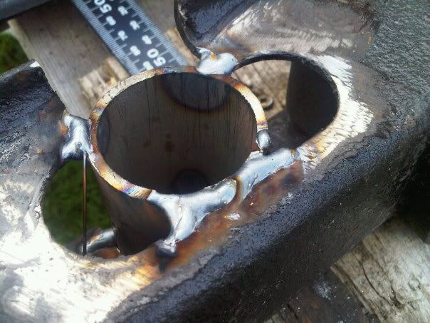

Craig,
how's my welding look?

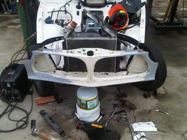

since it's been raining here, all i did today after school was pull off the front nose-section and power-down the drivers seat so that i could figure out the position.
Neighbours saw me sitting in there with my helmet on making vroom vroom sounds.... i really do wonder what they think of me sometimes... hah.
i've got a good 2" of clearance with a helmet on, and the back seat is probably not usable with my seating position... oh well!
That's a lot of heat...why is the wire still attached? It'll stick. =D>
PostPosted: Wed Sep 08, 2010 9:46 pm
that was un-cleaned, and really just tacked to setup my rear end. i'm starting to "hear" it now, i'd say took probably 20-30 hours of practise to get right, it's becoming more natural though :)

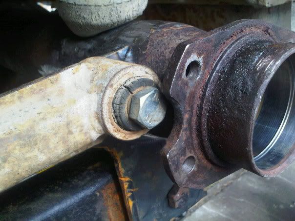

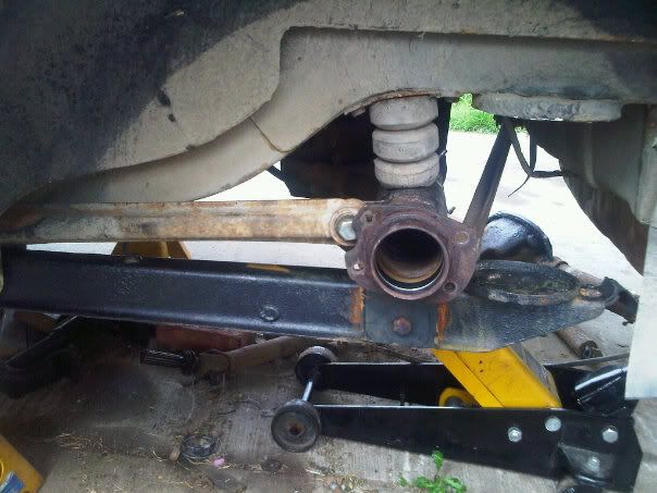

got sick of looking at the housing....
not bad, 3.5 degrees of pinion angle.
this however, is bad news, i'm gonna have to probably do something with a heim joint and reduce the thickness
the whole thing fits rather well however...

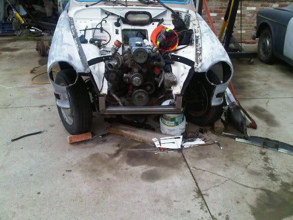

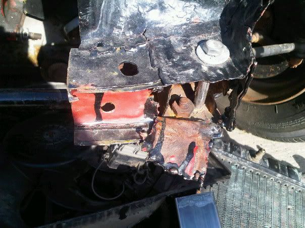

I like the little milling machine...be careful with that front cross member - been there, done that and you've got to make sure things are strong up front...that thing isn't there just to hold the rad up.
PostPosted: Sun Sep 12, 2010 6:57 pm
hmm, yeah, the steering box seems like it puts quite the force there. i'm goign to build little wedge-type gussets out of some of this leftover tube. one on each side for the drop in the rad xmember to the front frame rails, and another on the inside of each corner of the xmember.
PostPosted: Wed Sep 15, 2010 6:35 pm
got the first part welded in, still need to brace/gusset it.

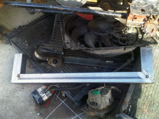

PostPosted: Sat Sep 18, 2010 9:32 pm

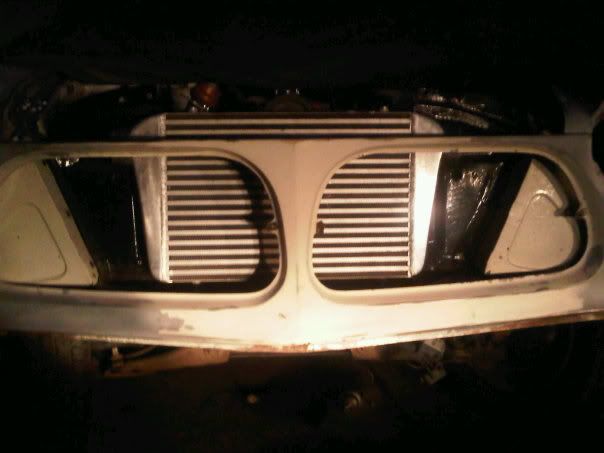

got the rad fitted with a taurus 3.8 efan, it fits. now i'm just trying to figure out how to actually mount the radiator... are the 4 holes in the back of it enough to support it?
the IC is going to be a neat fit, i need to determine if i'm going to raise the IC up and hang the oil cooler under it, or if i'm going to hang the oil cooler off the whole shebang possibly out in danger's way.

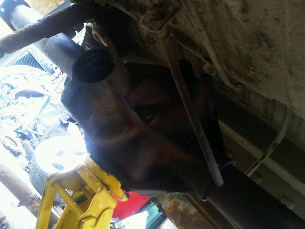

PostPosted: Sun Sep 19, 2010 2:35 pm
just pulled the axle housing again, got it all lined up properly and tacked on both brackets. mission accomplished. It is now centered within about 2mm (or i can't read within about 2mm from the big squares i used to measure it)
