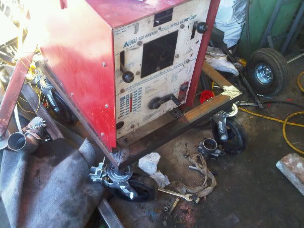

That means building a rolling welding cart, complete with both welders, the plasma, the tanks, etc.... clear up some floor space! as well, build the new stand that this milling machine needs. quite possibly make it portable as well with locking casters. and then the crown on the whole thing, mounting the engine in the PV because it's about bloody time, and that lump is sitting in the middle of the garage taking up an insane amount of floor space. Then organizing my tools, clearing out some of the junk, de-greasing the floors and stuff some. anyone need any 240 parts? dual round/flathood/gt front sway bar/anything?

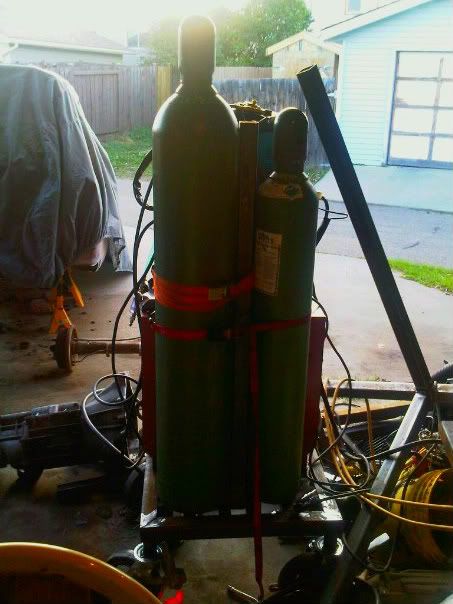

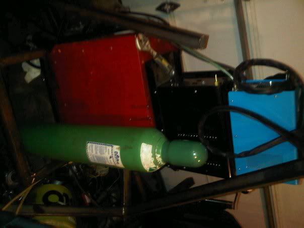

started building a welding/plasma cutting cart.... just trying to figure out how/where to mount the two tanks (The other tank is a 330 cu.ft. tank), and where to mount the hoses/cords/cables/etc.
for the cylinders, i'm probably going to put a 2x2" post up to the height of the largest cylinder, then put another piece of angle iron at the bottom across the frame, and then another piece on the other side to fit the outside diameter of the cylinder inside the angle iron, then strap them to the post, or use a round hoop to keep them secure.
i'll mount a power bar on top of the tig/stick welder for my grinders/etc. and have the plasma/tig with the 220 extension off the back. then probably mount some angle iron on the front with some tabs to wrap ground wires/torches/guns around.

got the upright on the welding cart done between homework tonight!
lifted the tanks in and strapped them up (It's bloody hard to lift the big tank by the cap by yourself!)
gotta make a rack for the wires/power bar/air feed, and it'll be good to go!

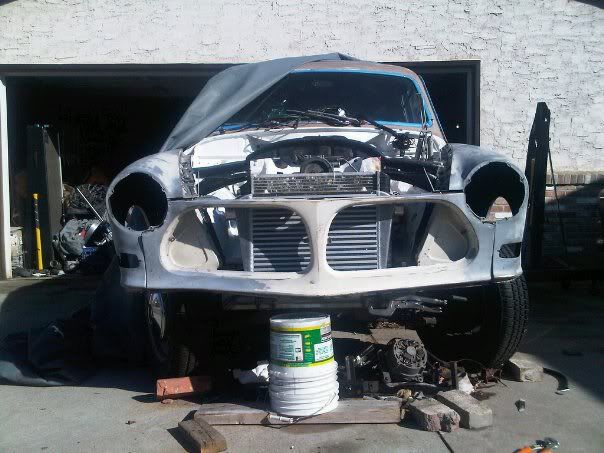

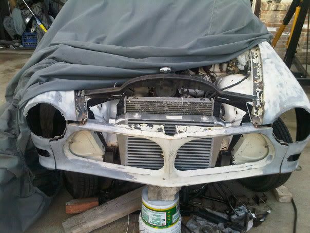

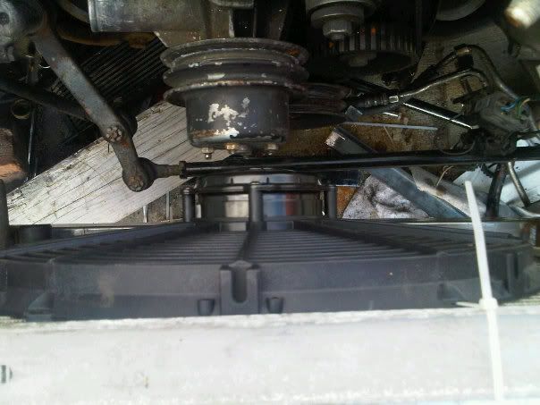

got the IC mounted. gonna get the the rad mounted when my refractory is setting.

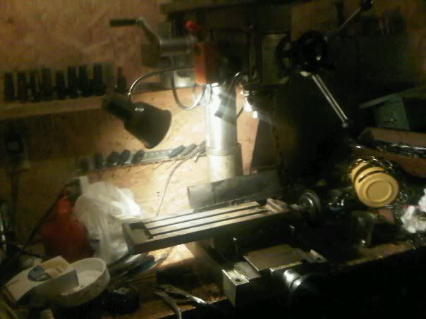

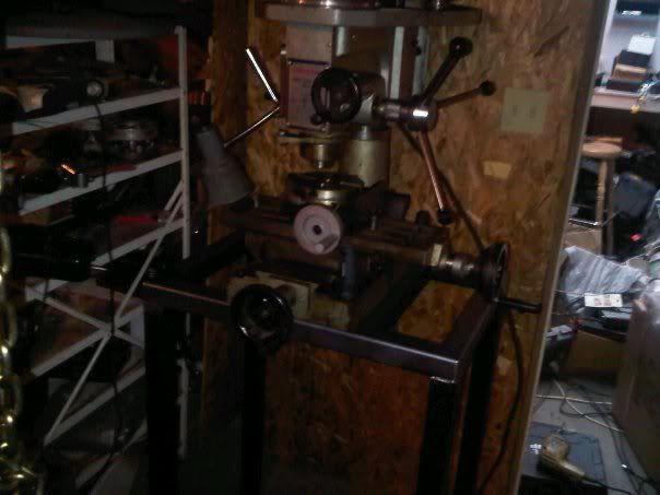

PostPosted: Sat Oct 23, 2010 7:32 pm
stand done! now i'm in the process of setting up the mill :D

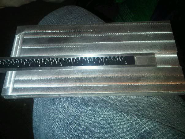

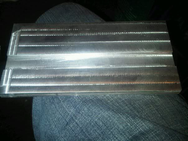

PostPosted: Sun Oct 24, 2010 4:35 pm
wow! this isn't as hard to do as i had thought!

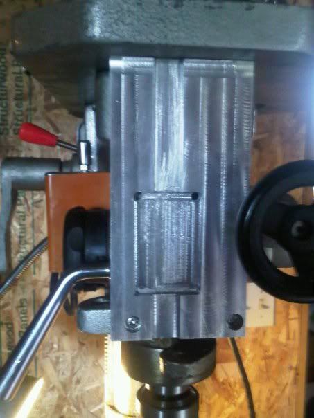

i know it looks like nothing, but this is the first piece i've milled. and i'm darn proud of it!

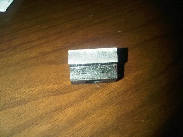

just took some of the generic T nuts and cut them down to fit in the rong-fu mill/drill.
next: oil preheater, after that, 8.8 spacer.... after that.... who knows!

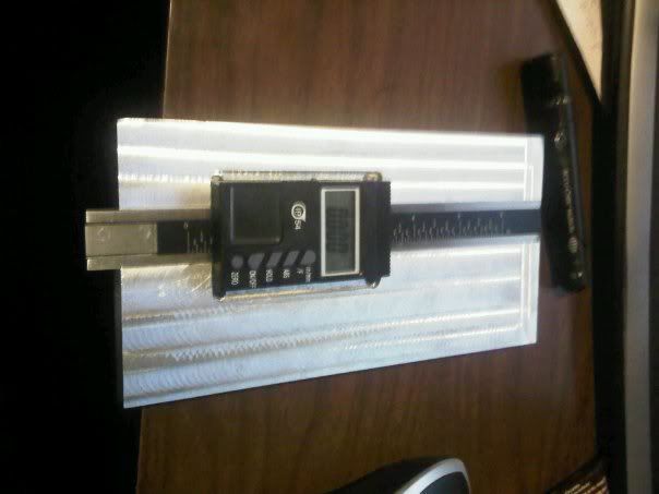

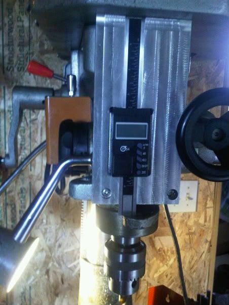

after mangling a few inches of 1.5" sched 40 BSP to try and make this rear spacer, i figured out that one revolution on my Z axis is 0.105".... soo i decided to build a DRO out of a $45 height gauge and some scrap aluminum from when i was learning to oxy-weld alu.
PostPosted: Sun Oct 31, 2010 5:21 pm
dro nearly completed. only had a couple hours to try and finish it today between homework and hallow's eve shenanigans.
