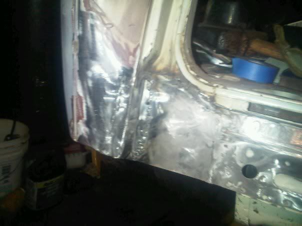

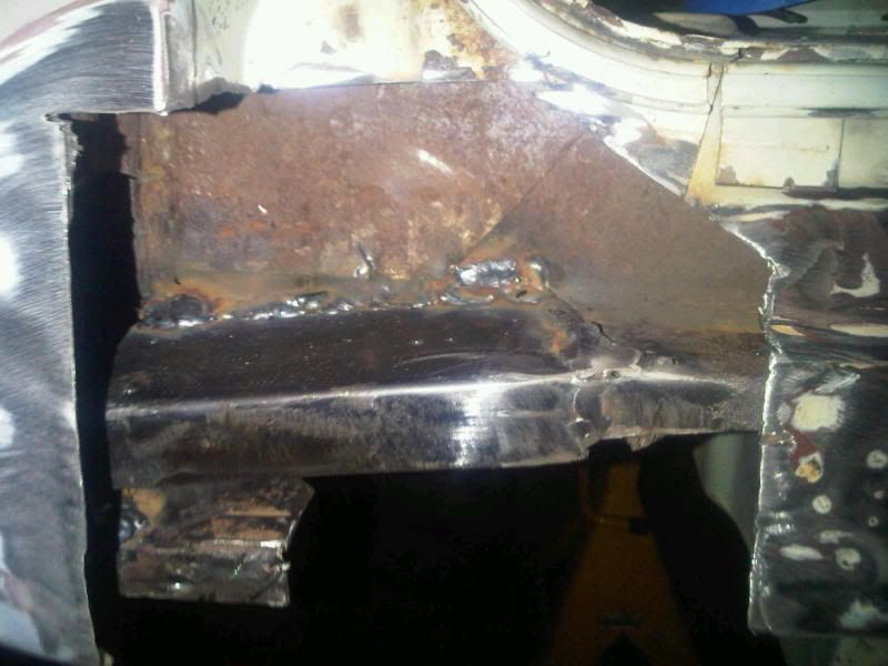

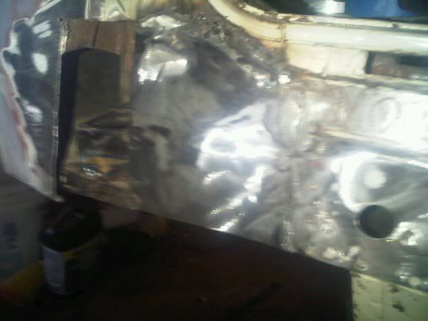

started on the other side today, taking the slightly different approach to it. Seems to be going much smoother this side, but the random little pocks of rust sure make the welding a bit goobery in places. it was cold enough too today i took a plastic ball peen hammer and knocked off a lot of the undercoating around this area, it will get replaced with truck bed liner.

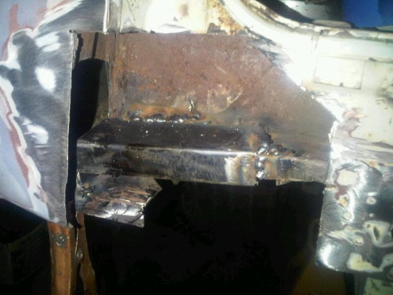

BUT, i've got more sheet metal in! been quite productive this weekend despite doing more life-enjoyment than usual.

I'm please to read that you are planning on using the t-b liner. I'd still use the rust-converter, then a good primer, so-as to make sure you have good adhesion to the metal.
As far as stickability is concerned, I was pleased to see that on the rubber hose from the gas-tank to the filler-spout, which was also covered with the t-b liner, pushing in and out on the rubber, the liner also flexes. I was quite surprised, actually, now it is just a question of how long that lasts.
Also, when you come to do the spraying, the two parts have to be mixed very, very well, or the product comes-out all lumpy, and can clog your gun. Mine wasn't mixed well-enough, even though I did it for longer than recommeded - albiet only with a stick. I bought two kits (Gater Guard truck-bed liner), and it was still not quite enough to do the entire undercarriage, including the wheel-wells, rear axle and all of the trailing-arm bits.
Also also, it was very awkward to spray underneath the car with the shootz-gun, as I couldn't tilt the can back far enough to spray straight-up, cause then the product doesn't come out. I had the car up maybe a foot and a half on blocks, but another foot would have been very helpful. Plus, you will need good lighting under there.
All the best.

I'm going to chip as much of the old undercoating off as i can as the first step, treat all the internal panels with the 3m internal anti-rust sealant, that stuff sticks like snot, it's great.
Then the outside will get washed down with solvent, sprayed with rust converter, covered in a high-build epoxy primer, and then the bedliner.
i've gotta finish up the sheet metal work first. hah.

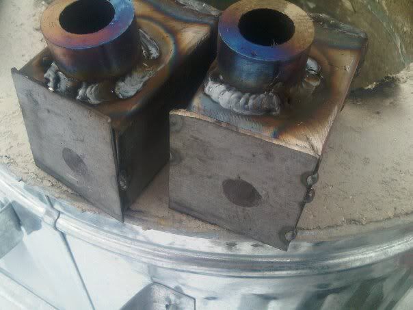

turned down some CDS i had around to fit the pins on the RX8 seats and welded them onto the brackets i'm making...

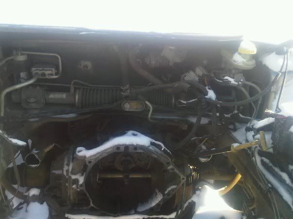

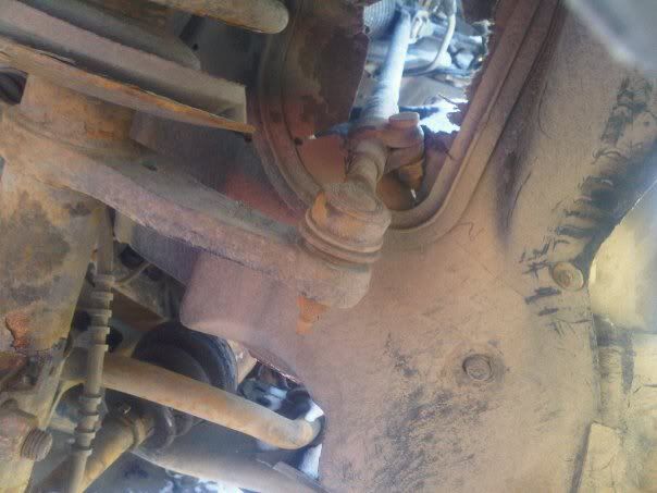

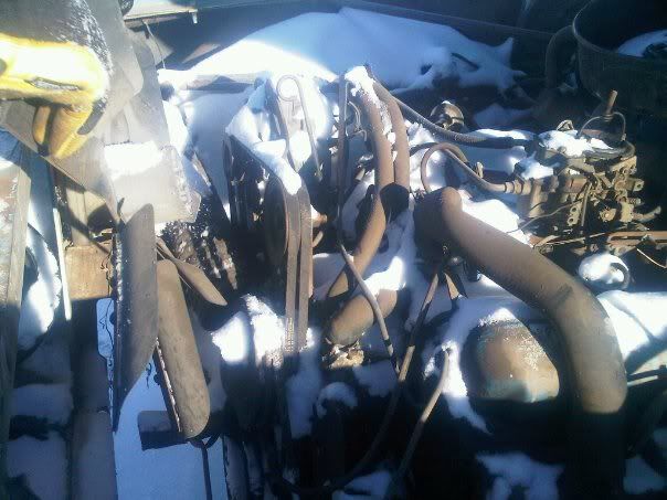

but i was out junkyarding today, and spotted one of those intrepid racks with the engine pulled, was helping a bud so i didn't have any tools of my own there to yank it, BUT to get an idea for fitment/etc...
Looks like it would work fairly well, and you'd be able to dial in the geometry decently.

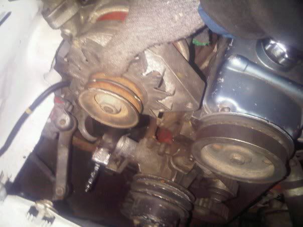

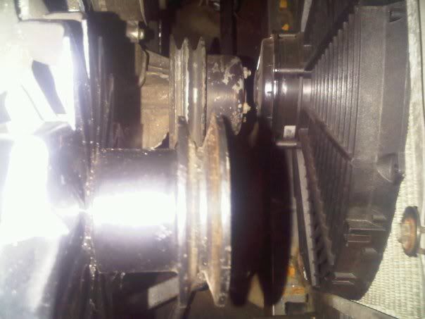

Now, was also considering the poor geometry my alternator will have mounted way off on the side of the head..
so was looking for an oem-ish solution, and found this on a sorta-old monaco.

working on an alternator mount made out of a PS bracket and some 18ga tubing i've got kicking around

have a mount roughed-out now, just gotta make the belts square up, weld on the back-half and then build the tensioner.
using an 85A (i think) bmw alt.
