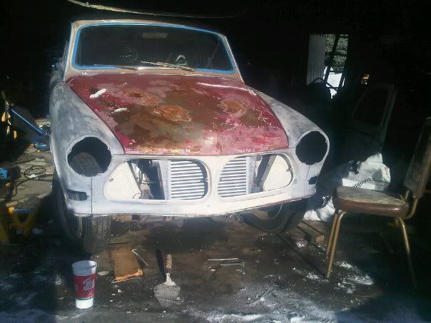

Found a good hood today! A little rusty, but it'll do!

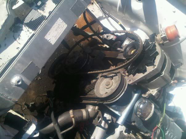

and shows the terrible belt geometry... means i'm gonna need an idler of some type on here....
any junkyard suggestions?

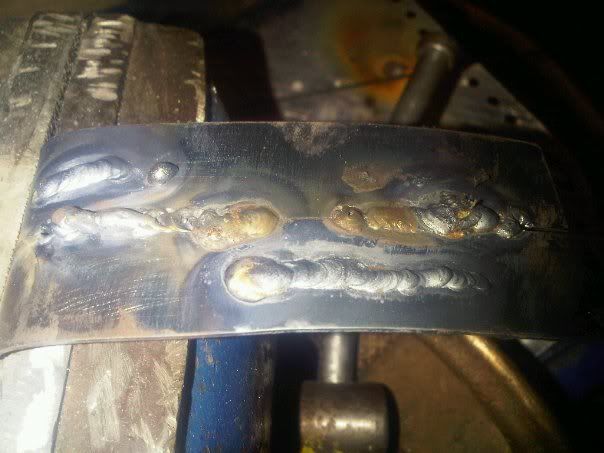

new regulator on, need a collet for the smaller tungsten since i'm using 1/8" right now on this stuff :S
but, here's a few practise beads on some 18ga steel. i think i have the current up a bit too high still.
the middle is the first try, then the top is next then the bottom is the last one, i think i'm gonna need a lot of seat time here.
