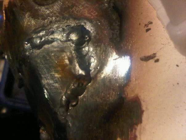

did up one side of the mounts for the PV today since i don't have a collet for the smaller electrodes, and wanted to practise. made a tight (~.3-.5mm) fitup and used probably two dips of filler and fusion welded it as i would with an oxy-torch at about 110A on DCEN after tacking at 140A The sheet is 1/8" mild steel.
PostPosted: Sun Mar 20, 2011 3:08 pm
I can't tell from what you've posted, but steel only needs about 10 - 15 cfm of argon and 110 A sounds hot to me - I'd have that as my top end (full pedal). Get yourself some collets - collet bodies and a gas lens...for doing 1/8" I would be at 3/32 or even 1/16" (open corner...1/16"). My Miller calculator suggests 12" a minute for the rate. You should be able to get your welds to lay a little flatter. I buy most of my TIG consumables from eBay - last time from a company in Thailand. They work great and you can get set up for not a lot.

So smaller and slower still eh?
The weld seems as strong or stronger than my mig welding though

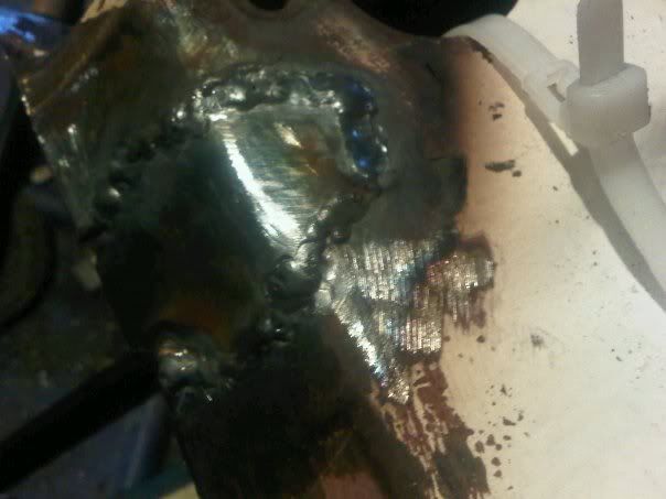

found a 3/32" lanthanated electrode and collet in the junk drawer at school, so took it home and ground it up and tried a little lap-weld before getting back to my paper..... it's a little nicer this time,
and played with a bunch of stainless after getting fed up with said report, ran out of tungsten, of course... so used a crusty balled up one and it seemed to help me get the idea of how to hold arc length and angles a bit better, i figure this is gonna take 10-15hrs of actual seat time to get the hang of enough to lay a nice bead.

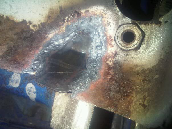

tried playing with some sheet metal in an hour i had free today, this is to close up a hole in the pedal/steering box in the amazon now that it's being relocated.
can't wait for my new collets/tungstens to get here from amazon.com....
