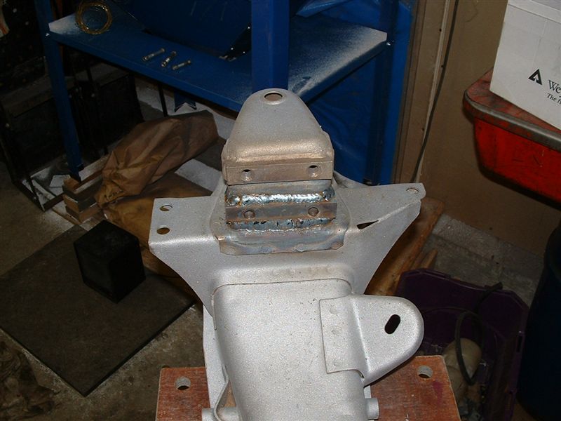

Craig/Dale, i remember reading about a mod to reinforce the crossmember/ move a set of bolt holes to gain some more camber. I can't seem to find the thread now, any hints on where to look/what to search?
PostPosted: Sun Jun 13, 2010 4:09 pm
Not so much reinforce but relocate mounting points for the upper control arms...
And it's Matt that gets the credit for this one, not Craig...

Awesome, so did anyone run how it changes the camber curves? How far did the mount move? How's it feel on the road?

Hmmm...a couple of things worth mentioning...
I believe the lower mounts are 2" lower. That's center of bolt hole to center of bolt hole.
I was using lowering springs that really had no...ummm...spring... I was running on the rubber bump stops most of the time. Because of this the car had massive amounts of negative camber. It was a bit of a handful on rutted pavement but seemed to drive fairly nicely on flat pavement. I did drive it to 2 different BC meets so likely put 4000km on it that way so it wasn't as bad as one would think. With proper springs the negative camber shouldn't be so bad and it should drive a little better. This time around I'll likely be running shortened 123GT springs.
The handling characteristics were like night and day. I had it to the autocross twice. Once with the original suspension configuration. The other in the modified position. In the original position the car wouldn't turn. I'd go into a corner and turn the wheel and nothing...just plowed. On and off the gas. On and off the brake. Tried everything. Nothing worked until I got it slowed up enough and then it would finally turn. Really frustrating. The other time I was out running all the negative camber, you almost had to hang onto the wheel to keep it from turning sharper when you dipped into a turn. It would grab and pretty much yank you around the corner. No understeer whatsoever. Likely would've had issues with oversteer if the car had more power. As it was it would drift nicely out of corners with only a very slight wiggle of the rear end. It's going to be interesting this time around with twice as much power...
