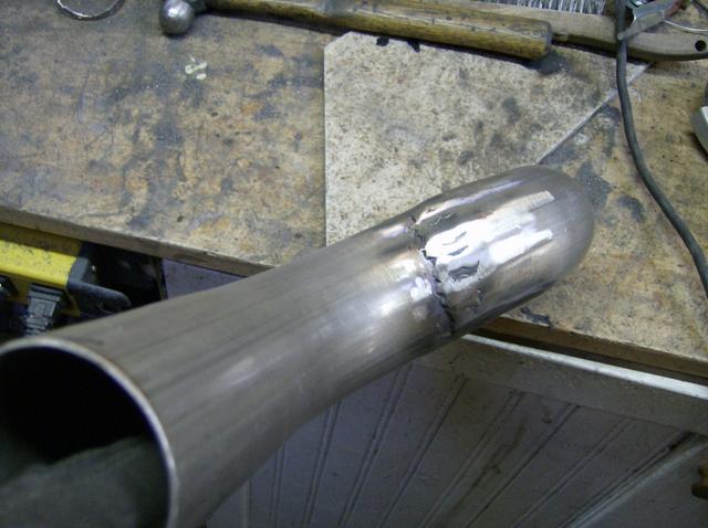

Next was the join from the main muffler to the down pipe - it needed a tight turn to get it in the right place and keep the muffler tucked up. The turn was tighter than the radius of my mandrel bends, so I sectioned them a little closer than normal and then bent and welded them back up...I'll let the pictures explain.
