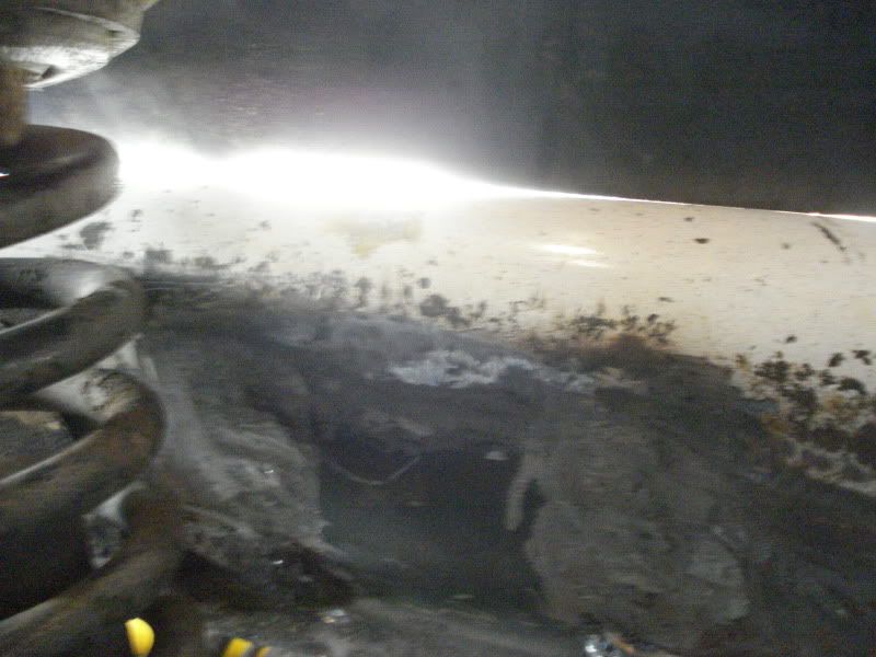

found some nasty rust in the drivers side frame spar behind where the suspension mounts, tore open the rail/spar there and have now fixed the bottom piece. still working on the support bracket and then the side. So the PA mig works quite darn well on this stuff, on the 3'rd/4 heat setting and wire speed of about 2/10 on the scale, it lays a decently flat bead (when i remember to turn the gas on) and little distortion with decent penetration. The stock 1.3 or so mm(17-18ga sheet?) seems a tad thin for this application, but we'll see how it all comes together. have to do a drawing for the sheet metal guys again to get my rails bent up. but 14ga channel with 3/4" ears had ought to do it.
EDIT 2:
Got the rail patched today, getting a little bit more comfortable with this whole welding thing, getting great penetration and HAZ but on the vertical welds my bead is a bit high, just makes for more grinding.

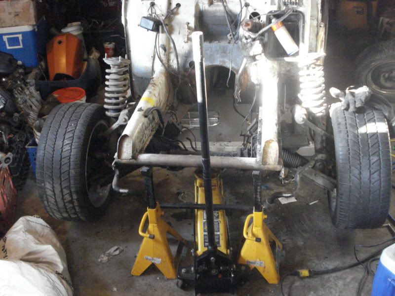

cleaned up my patch, knocked off the bracket for the master cylinder, and jacked the supra suspension underneath, looks like it will work SMASHINGLY well stance wise, fitment wise and strength wise! May need to make a little bit shorter (2" or so) strut assembly to clear the wings with good margin, but otherwise not much is needed. . The steering rack though is pointing straight through the frame rail, so i'm thinking of cutting a hole on each side and running a piece of thinwall tube through it and then welding it in, and then having a u-joint on top. Anyone know where I can find info on maximum allowable deflection in steering u-joints and the like? are there any other solutions?

the distance between the centrelines of the mounting points in the supra is 180mm wheras the PV is 177, not bad at all. gotta get my crane back and trim out the the flanges to fit in the pipe, hoist the suspension up, line it all up, tack, check my fitment again, and then box it all in.
For the mounting I will be using 1.25" x 0.25" wall DOM welded to the 18ga sheet, it'll have a nylon bushing inside to centre the bolt, and then be boxed around with 18ga sheet again. the steering rack kind of points through the middle of the frame rail, so i'm trying to figure out if i'm best off notching the rail, or if it might be better to trim a hole in each end, insert a piece of tubing and make a through- for it with a u-joint on the top pointing to where I want it to go.

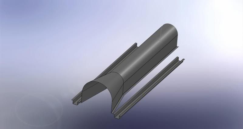

gonna hopefully have the rails this week sometime, and am working on the drawing of the new tranny tunnel.

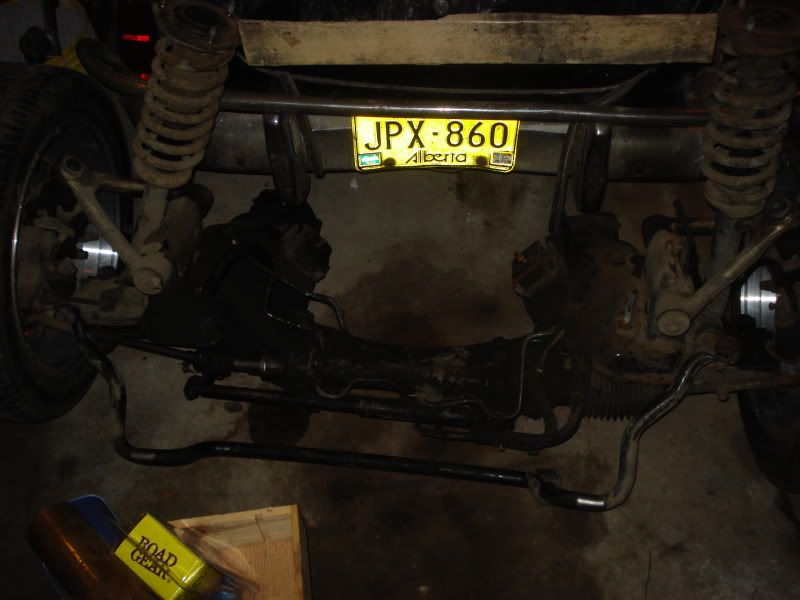

also picked up one of tohse 25$ 8" Digital calipers with the 0.01mm accuracy, measured out the supra suspension and through averaging 4 measurements (inside-inside, outside-outside) of the bolt holes, it turns out the spacing between them is 178mm exactly. compare this to the volvo spec of 177 +/- 0.15 and it's so darn close... so i broke up some C type channel (4 pieces), that gets mounted to the frame rail, then inside this goes the 0.049" wall tube to fit the 5/8" bolts then there are 3 braces between these two C type channels inbetween them and then 3 gussets per U channel facing to the front and rear of the car, after this there is a sheet metal piece that is bent to go over the whole shebang, gonna draw it up in a few mins.
The technique for going up-hill is different than welding in other positions. You have weave and go up and over in a reverse zig-zag. You can get the beads to lay flat with some practice. Looking great by the way.
