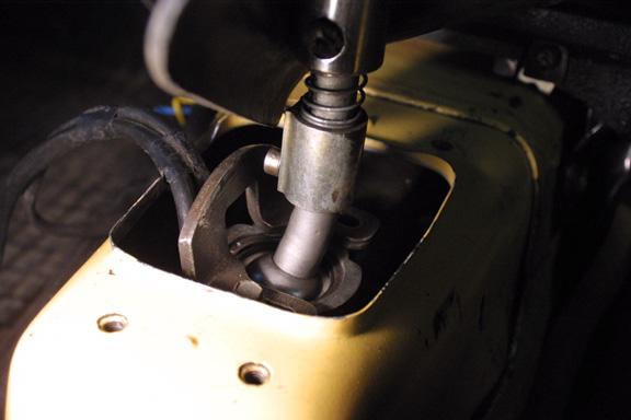

I looked at the pics Greg and it sure looks bent to me. It's been done before so it's not impossible. All I can say is the kid was certainly hammering on it to bend it period...

For those that are curious, here are some photos....
Here's the Avalanche short shift, mounted in place. Straight up.
Now here's how it is now.
Note the kink right where the flat spot for the reverse detent ends...not present in the first pic I don't think.....

holy crap....did he pull the knob off a couple times trying?
 Post subject: Ouch
PostPosted: Wed Apr 11, 2007 11:04 am
Man, he must have heaved on it to bend that shaft. Thanks for the shop info - I'm looking for some Falken's for the Canuck (when I get the steel wheels back from being widened) and they sell them...perhaps I'll keep looking.
