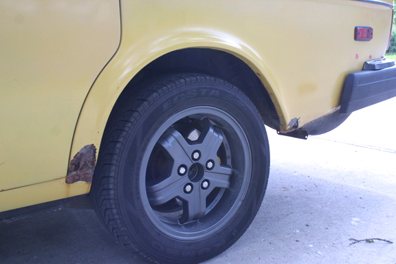

While the left side looks worse than the right, both sides have rot in front of the rear wheelwell, and on the bottom of the rear quarter panels. The right side has a bit more rot inside the wheelwell which will be fixed. The majority of the rust on the car is in these spots. They've been fixed with bondo before, but kept coming back. Time for sheet metal. The rest of the rust is mostly surface. Not bad for a car with nearly 500 k.

Here's a good view of the right rear rust, with the cutting beginning.
After the first cuts, with sound deadening removed as prep for welding.

Craig and I started on the right wheelwell. First up was cutting out the metal to inspect the damage.
The first layer was cut away, to reveal two small holes on the inner fender. Noting where the drainage hole was, and where the third layer of metal meets the second, it became obvious why the thing rusted where it did. The rust wasn't that bad though (three layers of thick sheet in some places!) and most of the metal was intact. Craig cut out some patches and welded 'em on, the first was bent along the inner well itself, and the second was smaller in the front.
