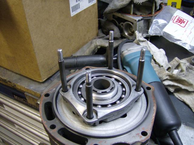

Small problem...my used M46 was taken apart last night for a set of gaskets and O-rings in the OD. When I took the bridge plates off in the OD, only one of the 4 nuts would come loose. The rest just spun - someone got things a little tight. Now, I could have waited for the OD to come out of the 242, but I thought, I can fix that.
So I ground off the stripped threads and welded up the studs. I didn't take any before pictures as we've all seen a stripped bolt before and grinding them down to 0.25" was just a lot of work.
Here they are welded and ground (8 - 12 ft lbs only - no tighter).
Here are the new threads cut - everything should go better now as I put it back together with all new seals and O-rings.

damn, that's impressive, how many die sizes did you have to use before going to the final thread?
 Post subject: Re: 242 Build Thread.
PostPosted: Fri Dec 11, 2009 4:38 pm
I went straight to threading them - no die sizes...I was raised in a machine shop - I should have put a "don't try this at home" as the subject to the post.
