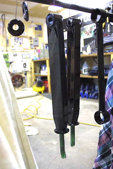

PostPosted: Sun Nov 25, 2007 5:06 pm
Here's the weekend kill I discovered in my garage....
Craig is handy with a gun. Photos don't do it justice. POR 15 sprayed on.
The shine is amazing. Pearly black. Makes me wanna paint my whole car with the stuff....
Diff cover and brake rotor.
The custom rods.
The whole unit dried, waiting to go in.
She's gonna be pretty. I'll let Craig fill in the details.
PostPosted: Sun Nov 25, 2007 10:04 pm
Great shots Greg, glad I let the pro handle the photo part of things. POR-15 sprayed so much better than I would have thought (having brushed a few gallons of the stuff over the years). It flows great, which is well known, but at about 40 PSI at the cap it sprays like a champ with very little over spray and great control. I'll be spraying it more often for sure. It also has high heat tollerance, so I used it on the brakes and rotor "hats", here are the brake rotors painted blue. In case anyone is wondering, I welded up the rotor bolt circle and had it re-drilled 5 - 4.5" to match my old wheels - thus the irregularity around the bolt circle. The welding rod I used in 90% nickel - hard as hell (just ask my machinist) :lol:.
