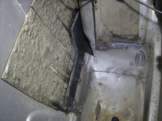

Here's the drivers side work. The inner fender had to be completely rebuild and I bridged and saved the butt cheek section. I didn't have as much sheet metal to replace on this side - so the repair is significantly smaller. Welds look good on the inside as well.
I've still got a few hours of rust busting to get rid of the surface rust, but then it will be all sorted and time to get it sanded and in a coat of primer. I can't wait for that stage of the process.
