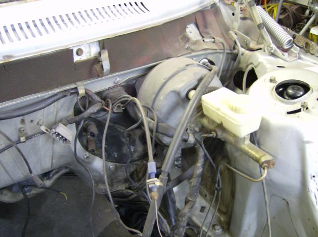

It's been a few days...and I've been going like crazy trying to get this car done. Needless to say, it's been fighting back and occasionally winning. I've been sanding so much that the ends of my fingers hurt, but the effort is starting to pay off. At the start of the week, I still had a lot of cleaning ahead of me. Here's the start point after several hours of cleaning.
Lots of goo still to clean here.
Plenty of nasty left here.
Don't even get me started about over here.
This one sort of sums it up.
All got hospital cleaned.
