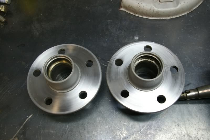

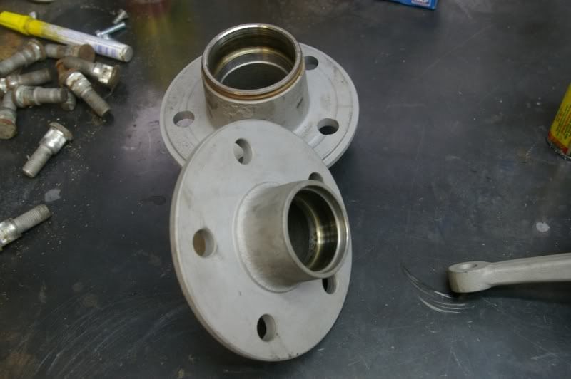

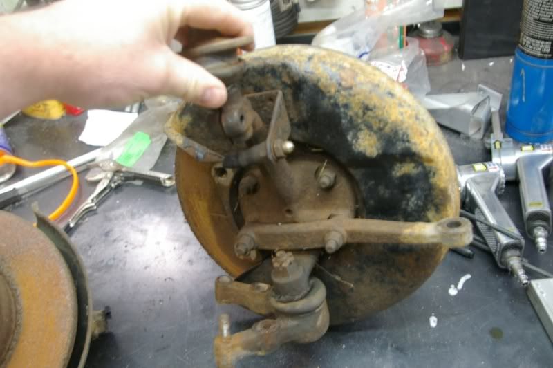

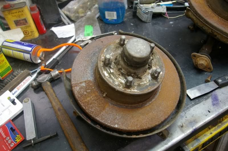

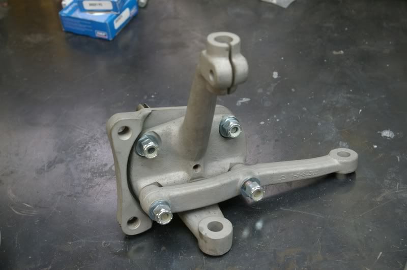

On to the current progress. I've been having trouble with wheel bearings and a little wobble in the front wheels. So I picked up a new set of hubs and have been rebuilding them.
Here's the start point - fresh from John Paulsen's compound....mmmm fresh.
A few hours of media blasting - blast cabinets are awesome.
"New" spindles. I probably won't change these parts, but at least I've got them.
The new hubs had around 3-4 thou of run out...right on spec, but they could be better.
So I chucked them in the lathe and turned them so they are perfect...no runout on this set!
I just have to wait for some new studs and a set of bearings to come in the mail and toss some paint at these hubs. Then I should be all fixed except for a paint job.

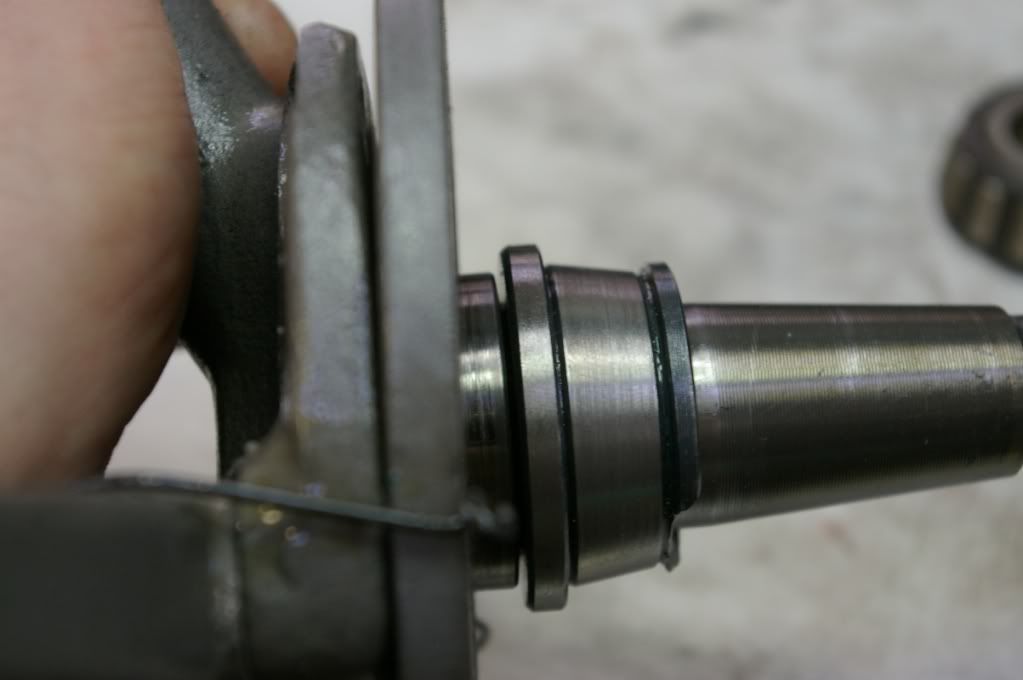

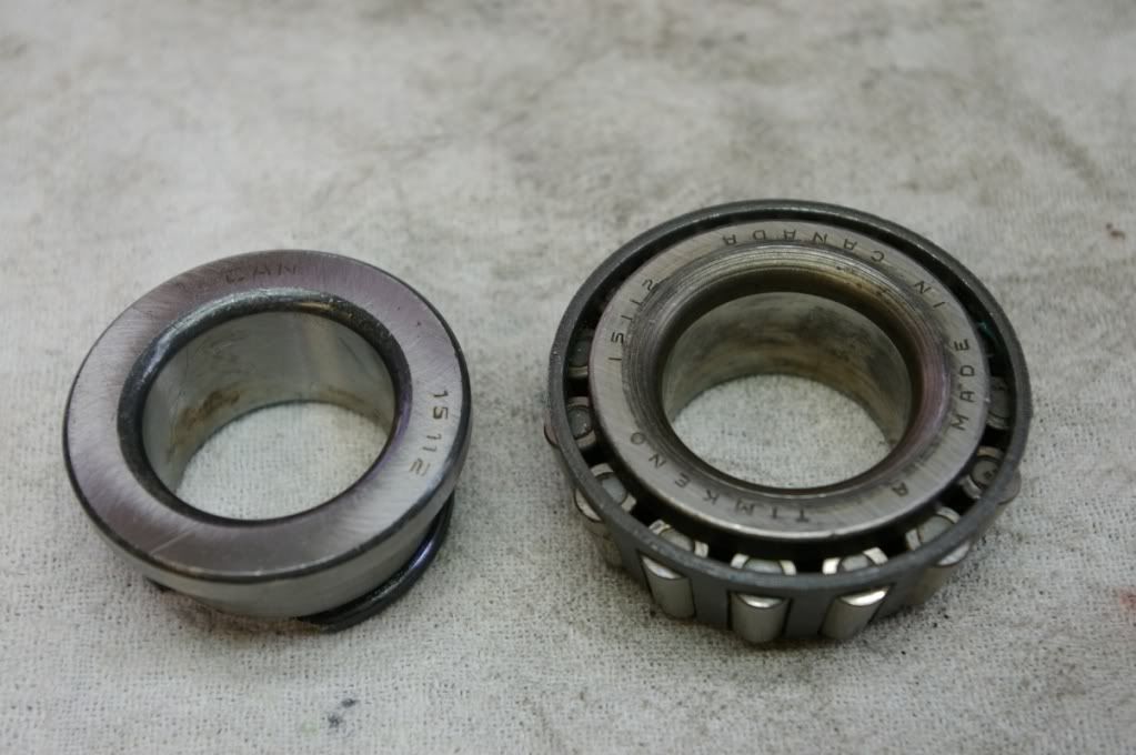

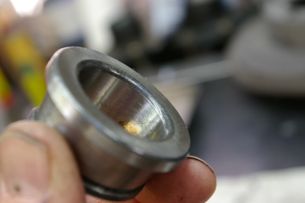

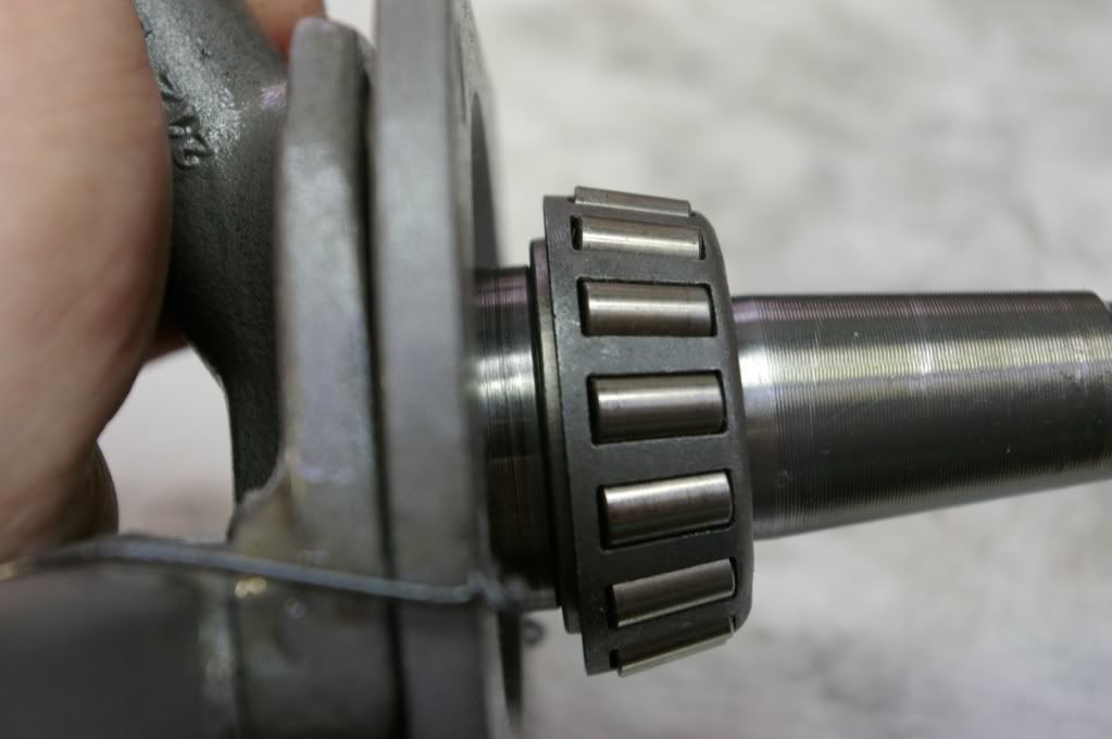

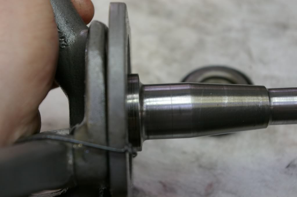

Well, I finally got around to cleaning up the garage after a busy couple of weeks. First up was to have a close look at why the front wheel bearings had gone south so fast. I've never had trouble with wheel bearings before, but the set that I got from Olof over at Vintage Import Parts seem to be jinxed.

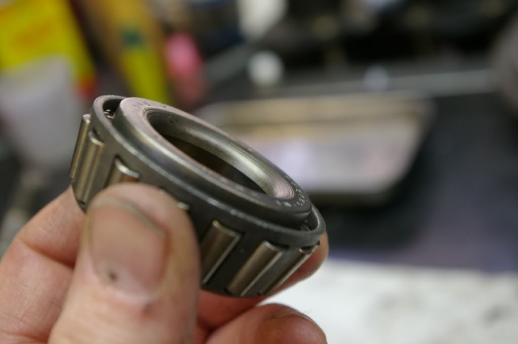

I cleaned all the bearings off for a look to see if I could determine what had happened. I had to CUT the inner bearing off the spindle - I've done this before but as the idea is to load the bearing against the shoulder of the hub, as soon as the load is released, they should just slide right off. I kept one inner race for comparison to a standard Timken (they were replaced with SKF's).
Here's the spindle - note the radius where the rear bearing mounts.
Now here are the bearings...
Note that the part numbers are identical.
Generous Timken radius.
Not so generous Can radius. Note the shiny band right next to the radius.
Timken in running position - fit is good.
Can in running position...WTF.
So this was the problem. I had already replaced the outer bearings that I got from Olof as the cups were not ground correctly and set the bearing cage too deep - I had already installed the inner bearings and didn't think that anything was wrong with them. Well, not much I can do now. Next time, I'll look at the radius of the bearings a little more closely.
Another mystery solved.
