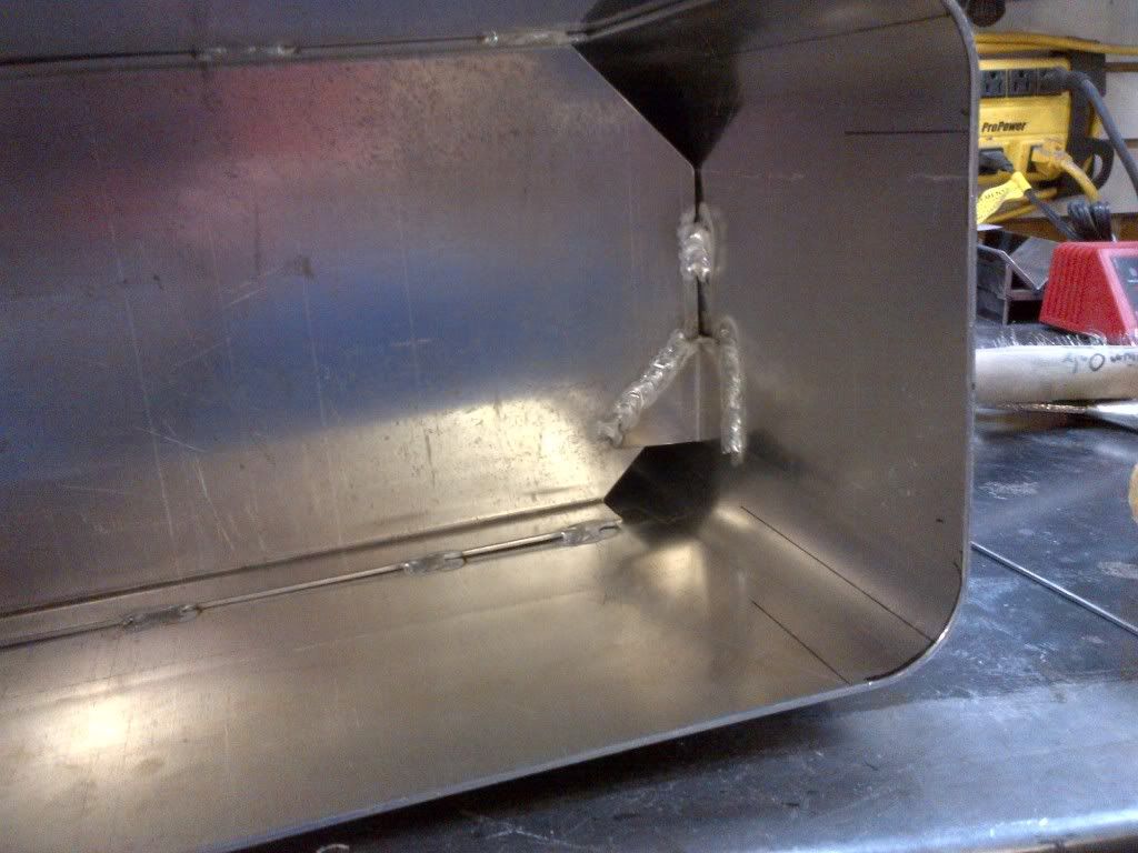

What size are those holes in the baffle? Were you going to do something to close them up, or is that it? I ask because I wonder if they're not too big, considering how quickly the engine will be drawing fuel from the tank. I think those holes might give the fuel plenty of time to flow away from the pickup sump.
If that's just meant to be a former to keep the tank square and steady, forget I said anything! :lol:
But the tank does look sexy! I hope you leave it nice & shiny and uncovered in the trunk.
Hmmm, good thought. I had thought of the purpose of these baffles from many different perspectives. The dimensions of the corner cuts were somewhat randomly devised based on other tanks that I've seen on the web. They do serve a stiffening/fabrication purpose, they do limit the amount of fuel bashing against my formed ends, but they may be a little large for the limit of fuel movement in a corner. At this point, I could easily reduce their size (for the bottom ones, not the top ones) and that would fix the cell fuel load better.
They are 1.5" on a side, what do you think about 1/2 that size? My only other concern is that as the size of the hole decreases, the stress on the baffles increases. I don't want the bashing of the fuel to rip the baffles out of the tank over time. Boat guys weld them in all the way around. I don't think a street car sees this sort of abuse (up and down through the waves and such).

Here's what I did - added some corners to: A. strengthen the wall/baffle connection and B. reduce the size of the hole to 1" square (ish). We'll call this the Dupuis modification.
You can see the reduction in size.
That's as good as it gets. Oh and for those that are wondering - TIG is very difficult to make work/pretty inside a 7.5" X 16.5" opening...so the welds are a little ugly.

A little ugly by professional standards perhaps, but considering the tight quarters (and that they're 10x better than mine at the best of times) they've got me in awe.
I'm thinking that the gaps in the stitch weld would have pasesd more than enough fuel from one partition to the other, even with your engine at full song, but what you've got is way better than the big empty box the car came with. What happens when a little sediment falls to the bottom of the tank and plugs off the gap, though? Better too much hole than too little.
I wouldn't be concerned with 1/3 of a half tank of 50 litres smashing those baffles off, no matter HOW hard you corner. Stronger is always better, but you're right - you're not dealing with 400 gallons in rough seas.
