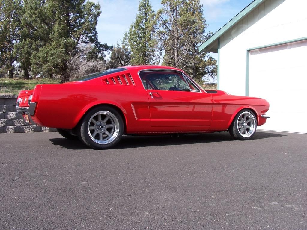

Just parking this here for now...here's a Mustang riding on Vintage Wheel Works V-48's at 17 X 7 with about the right offset. These are currently in the running for the car.
PostPosted: Mon Aug 12, 2013 10:08 pm
Okay, yes. I doubt they're terribly light, but they've got the right blend of modern and classic. I approve.
PostPosted: Tue Aug 13, 2013 9:50 am
+1. Big shiny lips and a Panasport like look to the spokes, I'd take a set for the wagon.
