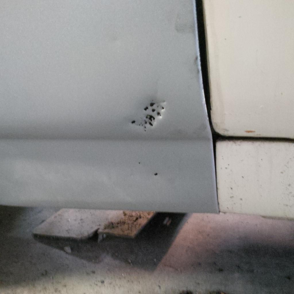

Here's a spot that I thought was light surface rust...turns out that it was a little thin and the blaster cut right through!
