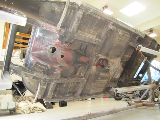

Yikes - The boxes that have the threaded holes that are behind where that transmission cross member is located are your transmission cross member mounts. They do appear to be in a different position ... they should be in line with the outriggers going to the A-post like on this underside shot. That's how they are for manual transmission cars.
So I'd tend to remove that girder that is under there and put in the correct cross member if you've got it. Patch up the frame rails and all will be fine.
Just as a note of caution - the frame rails on these cars are 16 ga steel and are not meant to have jack stands supporting the weight of the car on them. They dent rather easily. Use the stock jacking points (they are attached to the A post and bull strong) or get those stands up under the cross member.
