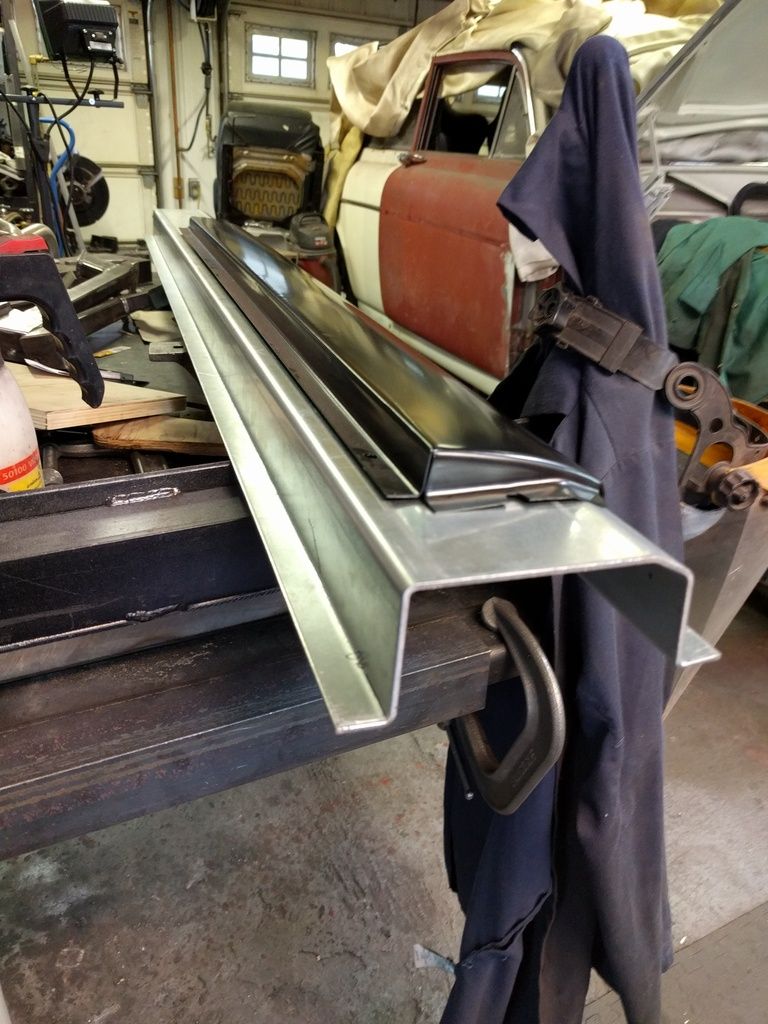

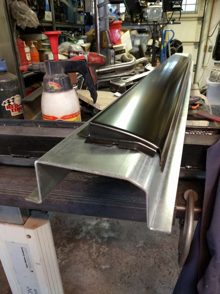

I had my local metal bashers knock out some new inner rocker panels. The replacements ones are uninspiring and this is the main "frame" of the car. I need as much stiffness as I can get and with 12 ga (galvanized) instead of 14 ga (stock) these should be around 40% stiffer. They are also going to be about 25% heavier. I'm not really worried about weight that is low in the car to be honest. They fit perfectly by the way. So when the floor panel that I need gets in and I get it installed, these will replace the originals and I'll get that part of the bodywork done.

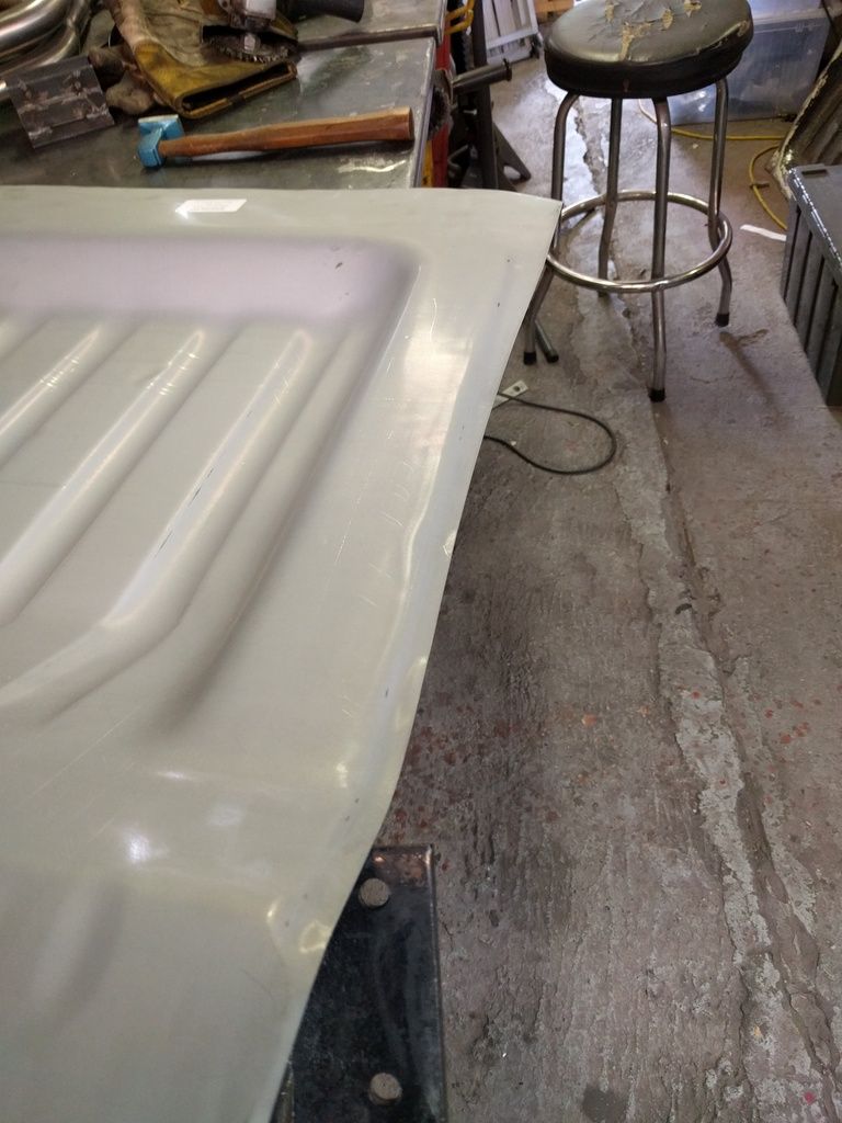

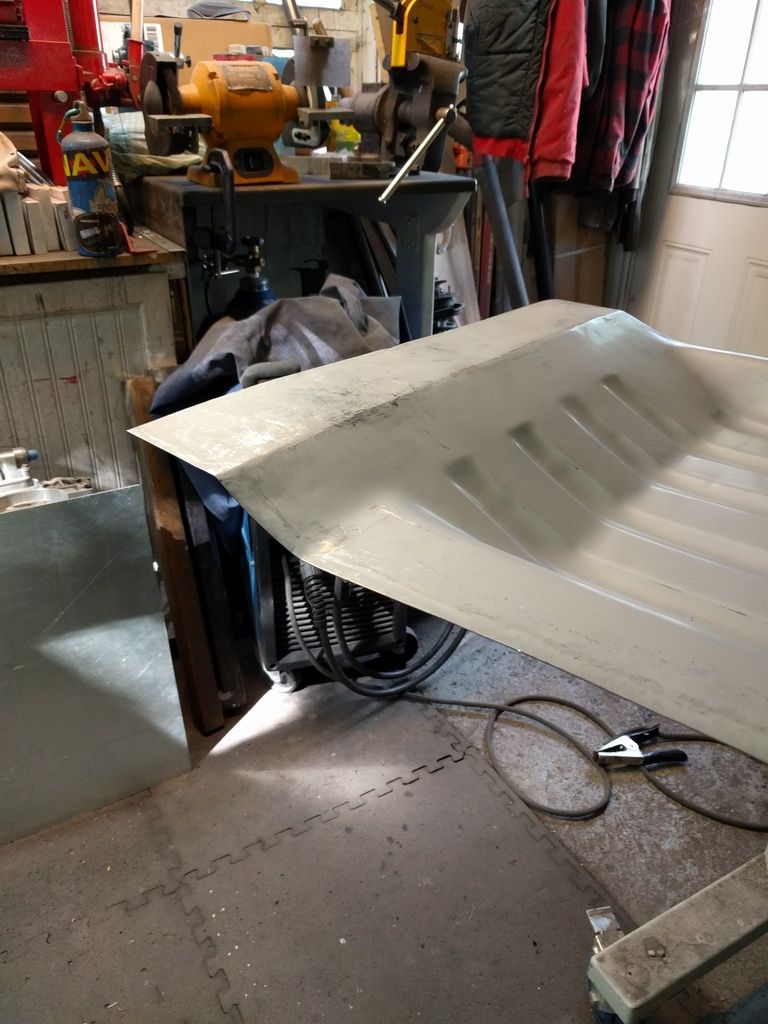

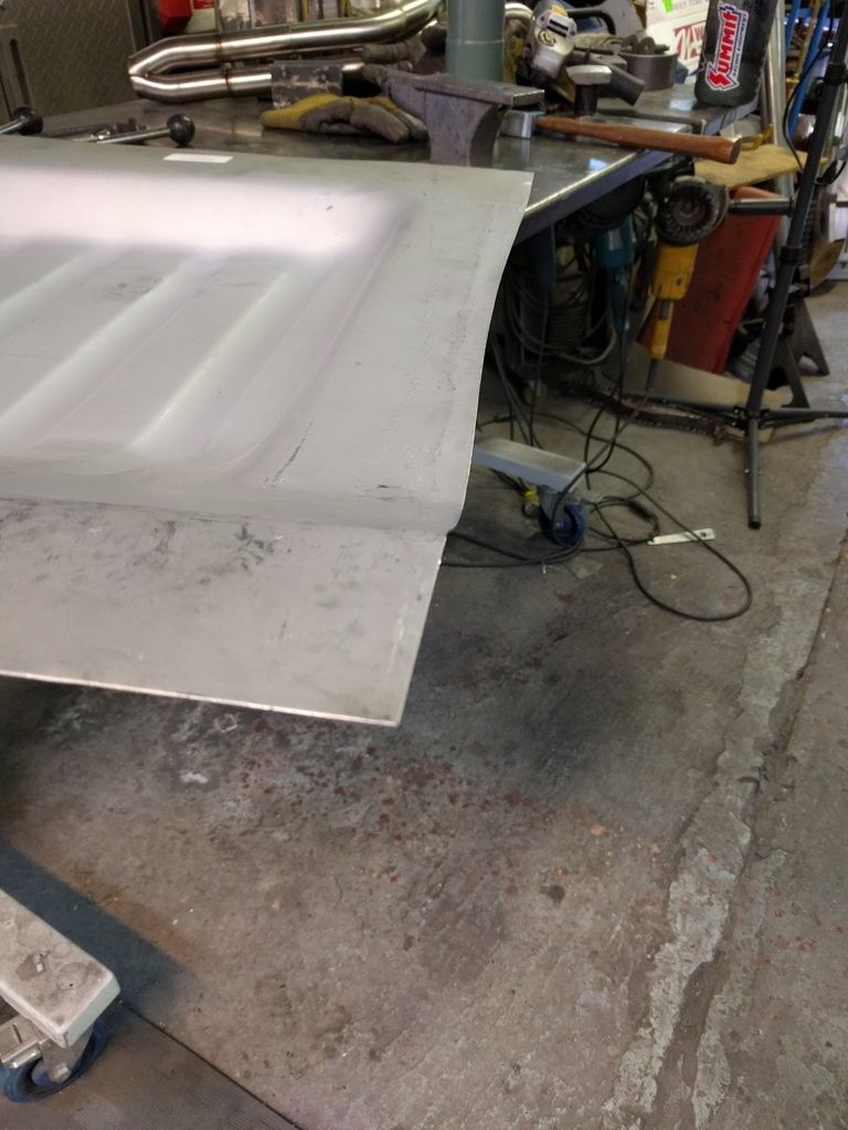

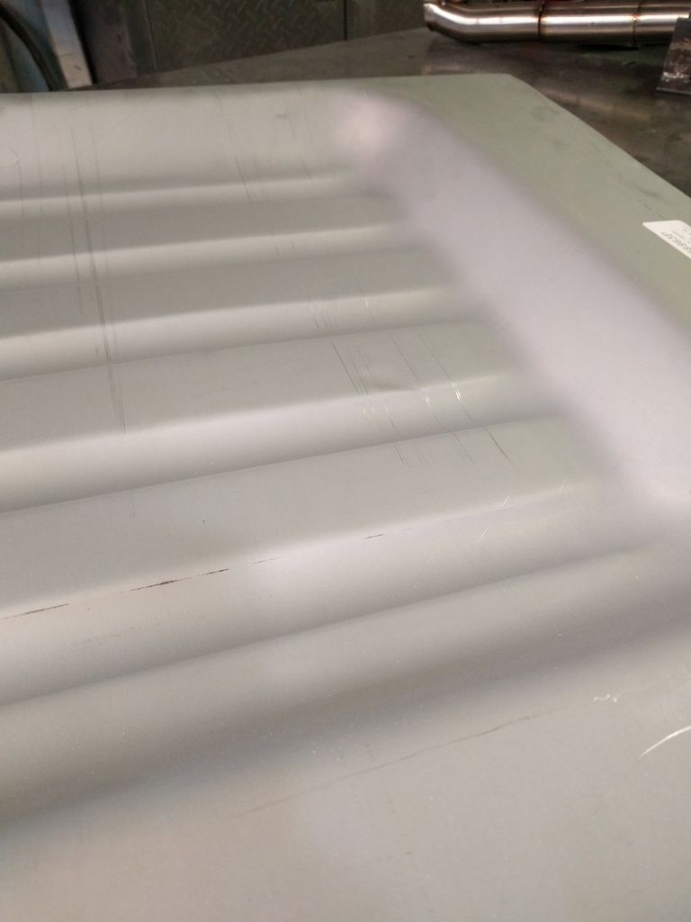

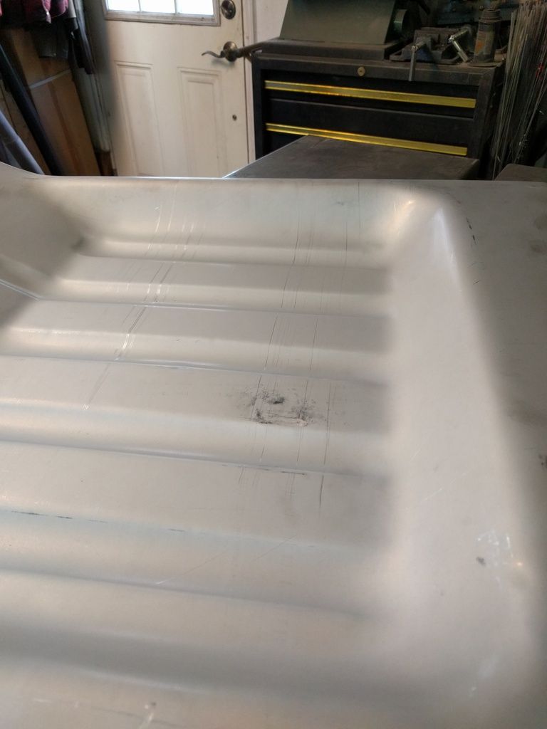

Next - the rear passenger side floor pan. It arrived pretty dented up. Flawed from the factory. I've got no time to send it back and get a better one - so I fixed it. Start.
There, that's better.
Then for the same treatment as the other side.
