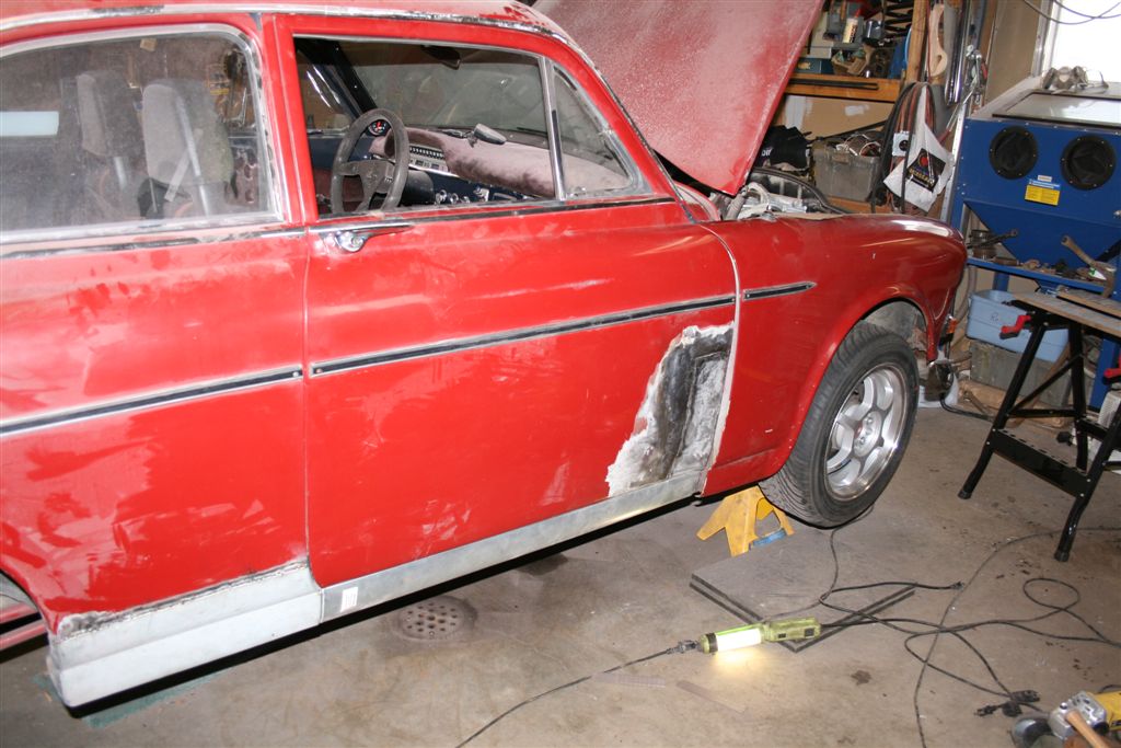

Well...it's been a long weekend...literally and figuratively. Craig came up Thursday night and we spent the better part of Friday, Saturday and Sunday working on my 122, replacing rusty stuff...
Here are a few "before" shots.
The first step is to fit up the various panels to see what we have and to see if what we have is sufficient to replace the rusted panels.
