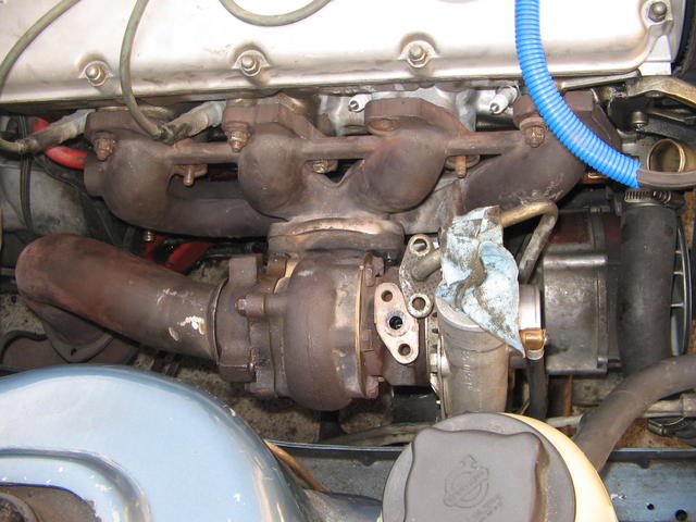

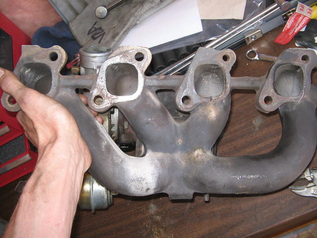

old manifold out
new ported 90+ bolted to the turbo

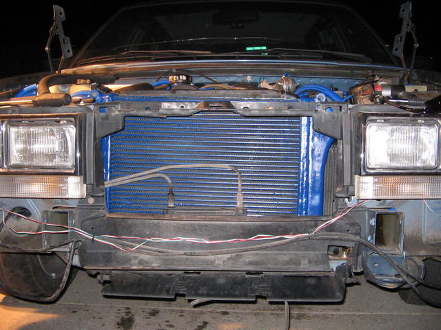

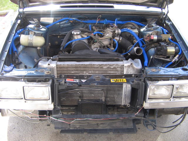

nissan UD intercooler, rushed, i will have to fix the mounting system...well make one anyway

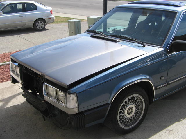

the Al hood...which i am going to go black for color, at least for this summer, i just want this F***ing car to be done so i can enjoy it
now this is kinda funny, well i thought it was after it happened, sometimes when i get angry it helps me to throw things, i relax after doing it, so i had a 3/8" ratchet in my hand and well from the driveway to the backyard gate, it's around 20 feet away, probably a little more...anyway...
so i did finally get the turbo/manifold/DP/Oil lines (thanks athal for coming by for a lil bit to aid) all bolted up, as well as some IC piping

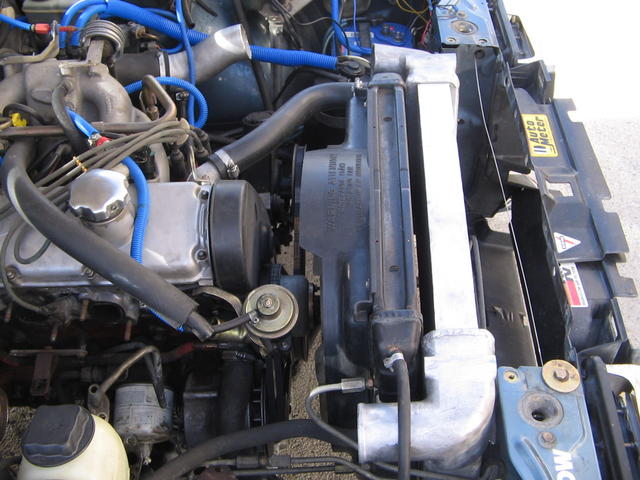

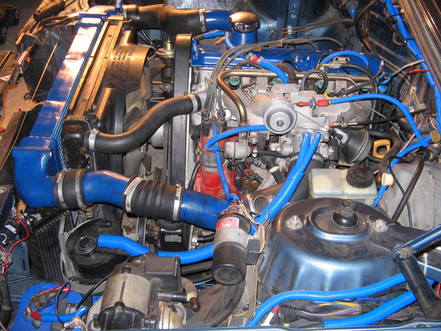

made some headway tonight with the warmer weather...so much blue i dont know if i can handle to massive power increase

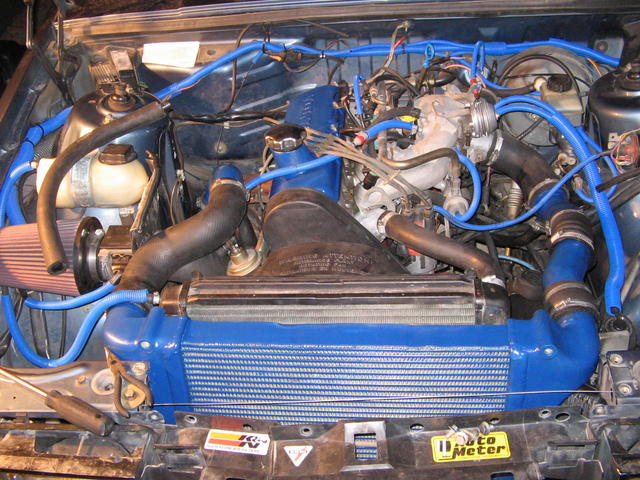

first of all I painted stuff and re did the IC "mounts", it sits a lot better now...tin-snips and pliers ftw when modding the engine bay...had the engine almost all back together...

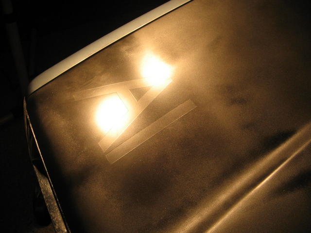

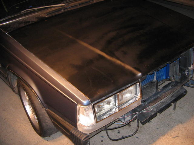

also painted the hood, well started to...sanded and primered, and first coat of un even paint layed down :lol: i like it but not so much cause it's not uniform yet...plus it is black, but better than the original grey, plus i got rid of the rock chips on it
AND at a certain angle of light reflection...there's a hidden message :wink:
so all in all i had a better night tonight...seems when making htings pretty and installing things which dont require more than a screwdriver i do pretty okay.... :lol:

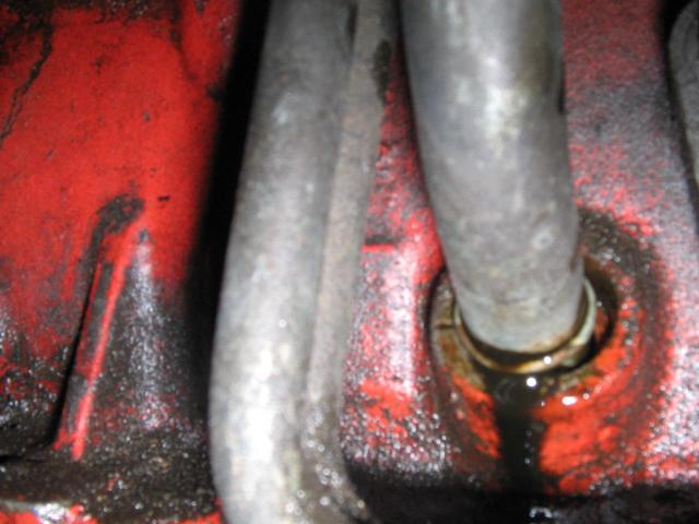

fired up the engine...shoot that sounds like open headers, oh no...exhaust manifold gasket leak? DP flange? start to feel around...oh yeah the O2 sensor hole in the DP...yeah i should put that thing back in... ](*,)
then i looked down...didnt JB weld the oil return like i wanted to...well now i know i have to... :oops:

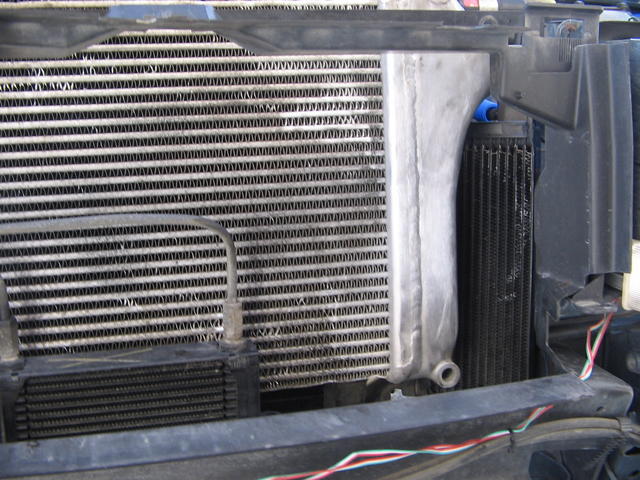

I say this with much love and no mockery: throttle the hell back on the blue, son. In my honest opinion, it's starting to look way too messy and cluttered under there, and it's kinda ... um ... what's that word?
What happened to polishing the IC? Got to be too much work, trying to smooth everything down from the rough cast? I REALLY don't like it blue - looks far too ghetto in my opinion.
Here's what I'd do, if you want to hear it:
Remove IC, take it to someone who can give it a chemical cleaning inside and out (will improve the efficiency two-fold - gets rid of the oxidization inside and the paint outside), and stick with polishing the tanks. At the very least, keep sanding 'em until they look uniform and you get to about 320 grit.
Look for some chrome or polished aluminum tubing on eBay, with whatever elbows it might have, and a bunch of blue silicone couplers, and cut it to fit. Get rid of ALL the black elbows & fittings. Something like this would get you started: http://cgi.ebay.com/ebaymotors/2-5-Inte ... dZViewItem
Look at some Goodyear Hi-Miler radiator hose kits - again blue silicone. Something like this, but they're not nearly as faded as they look in this picture: http://cgi.ebay.com/ebaymotors/1986-93- ... dZViewItem
Do something about that monochrome valve cover. Polish the lettering at the very least.
Get that timing cover on there. Again polished.
Then you'll need to look at it again and say, "how cheap does this split loom all over the place look? What could I use instead?
I know, I know - looking under the hood of my cars doesn't exactly scream "this guy's detail oriented", but I've looked under the hood of enough show cars to know what I like to see and what I don't: Clean and high tech, not just colour coded.

i know it's a cluster fvck under there right now...but A. i dont care to spend the time to polish it anymore and B. since other people have beat me to it for their engine bays i said screw it for this year...
i am bidding here...http://cgi.ebay.ca/ws/eBayISAPI.dll?Vie ... RK:MEBI:IT
so we will see...not spending another 150 CAD on the engine this year just for looks, i always can close the hood
and wire loom in my opinion looks better and functions better than 21 year old split all to hell rubber coating whatever the hell it is volvo uses
trust me it was isaac esque a few weeks ago with many wires everywhere
anyway, opinion noted and yes it will prob change, just not right now

Wire loom to cover wires is fine. Wire loom to cover hoses is not. I gots me plenty of that stuff - in black - inside my engine bay for the wiring harness.
PostPosted: Fri May 05, 2006 8:34 pm
hahah okay...i de-loom the hose and see how it looks

Vik i've got an O-ring set and you can grab the right one for your oil return if you want....still working for me.
PostPosted: Sat May 06, 2006 10:02 am
Even better, i found some of my braided silicone (or whatever) 1" hose I used for my oil return. Take 6 inches of that, cut 3 inches out of your return line and JB the bottom section to the block.
