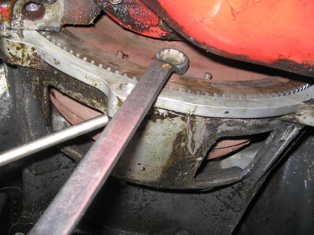

hammered on sockets on the bolts i couldnt get unstuck...suprised i didnt damage my sockets more but they seem okay...used the breaker bar and some choice words and it helped to get those bolts out...
it's all learn as you go right? thanks to Dale and Matt, once again, for steering me in the right direction, picture me sitting there...why the hell is this tranny not coming out??? hmm hmm

so Matt here is what i did, dug into my dad's old stash of tools, found a GRAY wrench...11/16", and had some fun...
this worked with 3 out of the 4 bolts, then i rounded two corners off the 4th, so i went to Rick Sr' stash and borrowed a 17mm and then the 4th came out
and tada!
yay slushbox out of the car!...
