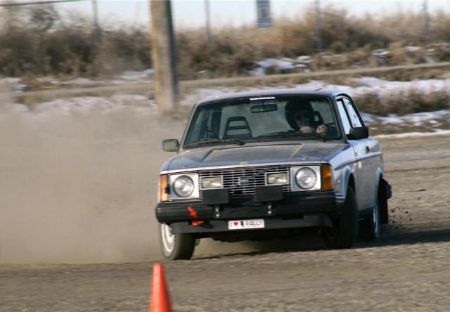

here is the GT as it sits now...

Time for an UPDATE! :D
