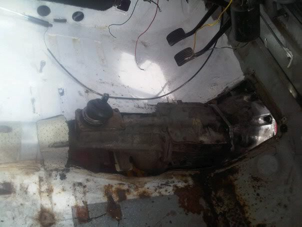

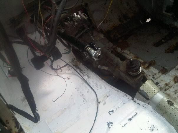

you can see my solution for the WG hitting the control arm bolt, now it's got a little spacer on it, so the arm just needs to be extended...

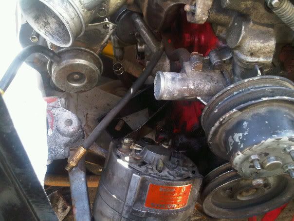

what small-case dual V groove alternators are there at the junkyard? I'm at a loss, but i'll get measuring tomorrow.
it seems as if i don't have a whole heck of a lot of room and may need to revise the motor mount setup some too...

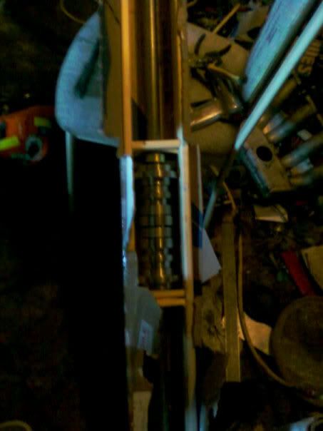

Look what came in the mail today!!!
and it's got all the pucks to do 8/8.8/9"/some chev/dana rear ends!
i'm frigging stoked! gonna cut down the housing for sure to fit the cobra rims in the stock wheel wells, measure out the axles and get them ordered! Then do the driveshaft!

I'm worried about the steering idler arm hitting the alt mount at full throttle/full lock, so i may actually lift the engine a half inch if it looks like clearance will be an issue. all details for a bit later though!

edit, found another pic of the drivers side of the motor.
