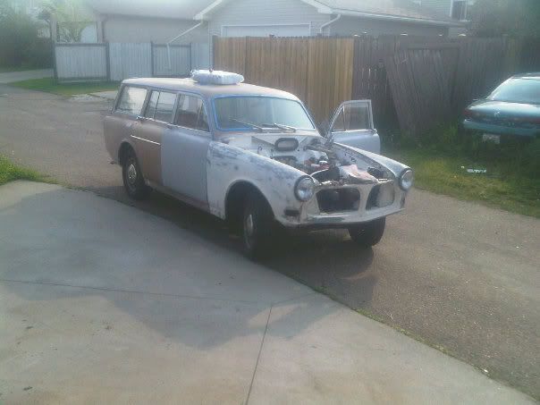

Ok...a couple...not much to see though...
Forgot to take a picture of the pile of stuff Matt brought over yesterday... #-o

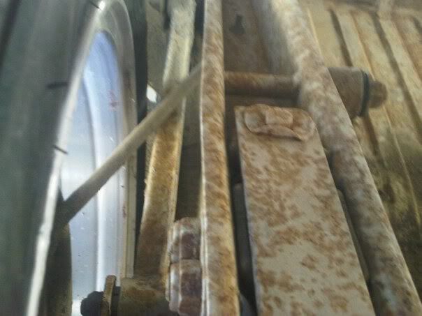

okay! working on the rear suspension now!
the upper links will be very close to interfering with the rims i'd like to use. what would y'alls feel about sectioning it to gain clearance? I know a bent tube (well, pressed steel bar) is always weaker than a straight one, BUT if i were to section it using some nice tubing, i may just be able to make it all work.
the other option is to attempt to remove the upper link brackets from the torque boxes, and swap left for right on the inside and relocate the shock a little bit. More work, harder work and harder to locate.

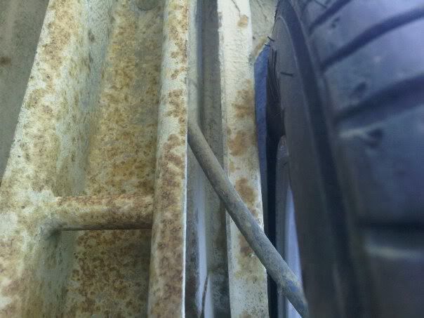

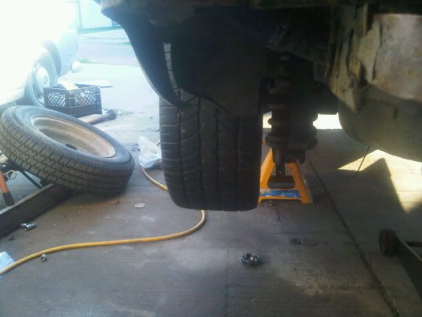

pulled the springs, went all the way up and down, looks like it'll clear well! Just need to sort out the upper link arms that is it.

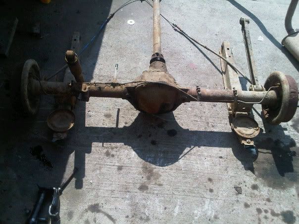

the stock rear end is 54" WMS to WMS exactly...
i should have measured my 8.8 before i yanked it out, but i believe it has 2.75" of stickout on each side from the axle flange to the outside face of the housing flange. That would make for a 48.5" rear end. I might use some washers, space things out to 50" and check everything again since that 1/4" per side might give me enough clearance... pics tomorrow!

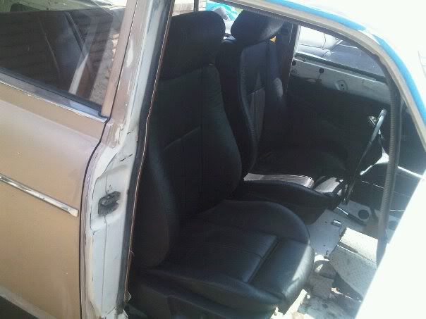

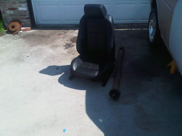

went to pull a driveshaft, it was so easy i managed to pick up a set of 2001 M5 power seats!

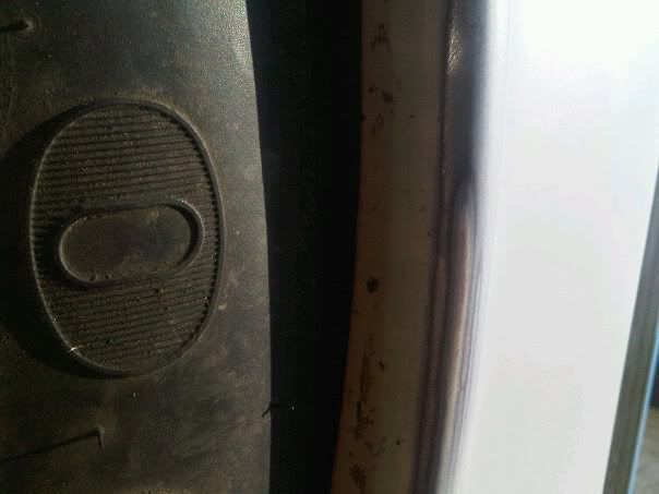

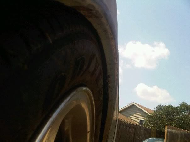

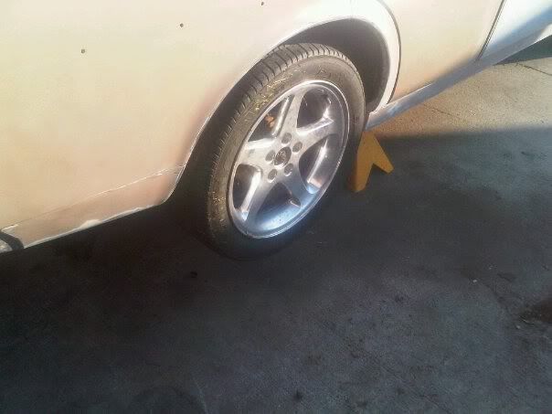

clearance information at 54.5" WMS TO WMS and some teasers :D
PostPosted: Sun Aug 01, 2010 3:36 pm
Nice and cozy back there. How wide are the tires?
PostPosted: Sun Aug 01, 2010 4:26 pm
those are goodyear eagle 245/45zr17s. I'll likely go with 225 or so just to give myself some room.

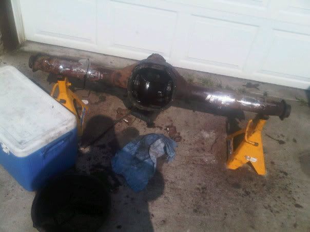

out with the old!
