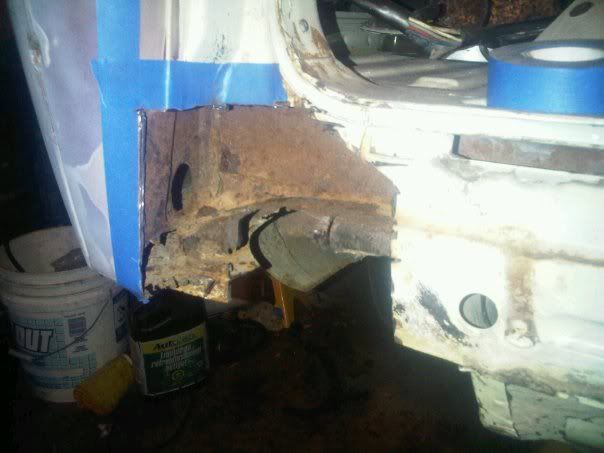

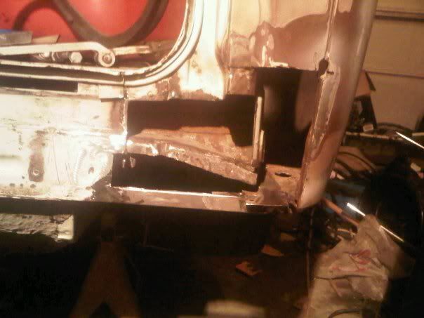

had an hour today to get things a little further along. Looking back now, this probably isn't the greatest way to get'er done, but it's good practise welding thin sheet.

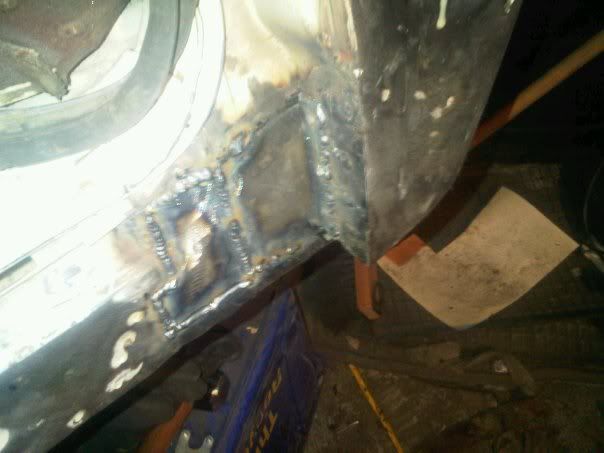

PostPosted: Sat Jan 22, 2011 3:54 pm
been looking up hammer forming, still having trouble figuring out how to make the tight bends...
but! i got a little more done too today!

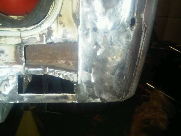

welded on the lip around the sheet i cut out, now just have to punch some holes in said lip, grind down my welding underneath it (loosely held on with a magnet for the shot) and get it welded on.
I'm probably going to make a bridge across the top portion, as there's been too much metal removed to fill with weld and not warp everything.
so i've gotta punch a few holes there and get it all tacked up too.

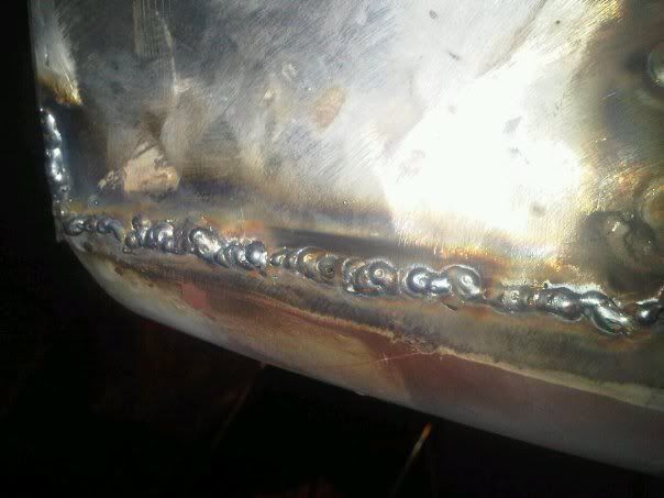

PostPosted: Sat Jan 22, 2011 7:21 pm

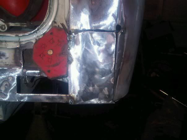

not the best work ever done, but certainly will do for this. few more slices to finish up, then doing the inside in panel protector and the outside in primer :D
then.... the driver's side.

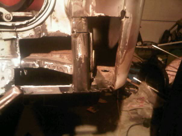

PostPosted: Sat Jan 22, 2011 9:48 pm
last one for the day!
i've put the 3m panel protector on it too, now just need to sand down the welds and hammer out the little bit of warpage.

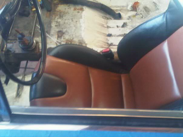

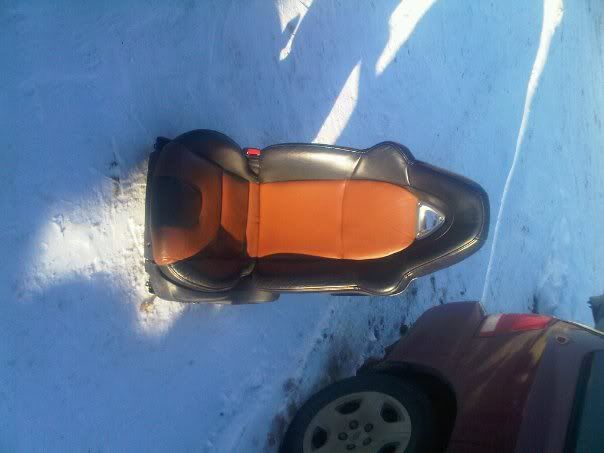

Got a line on a pair of RX8 two tone black/beige leather seats, the dimensions taken from a friends car say they should be the darn near ideal seat for me in this car! keeping my fingers/toes crossed!
PostPosted: Sun Jan 23, 2011 3:52 pm
the tip panned out!
only catch is it's missing the actual buttons for the seat, but i'll figure that out somehow or another. it's still usable as is.
and i need to figure out how to remove the airbag.
THESE SEATS FIT SUPERBLY! and fit me and my large frame VERY WELL! AND they're narrow enough to give me the clearances i need too!
booyeah!

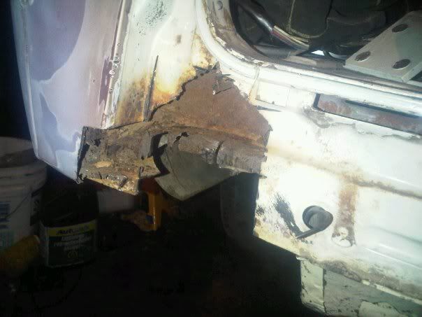

few more pics now that i've got the back torn apart on the other side (taking a slightly different approach here)
