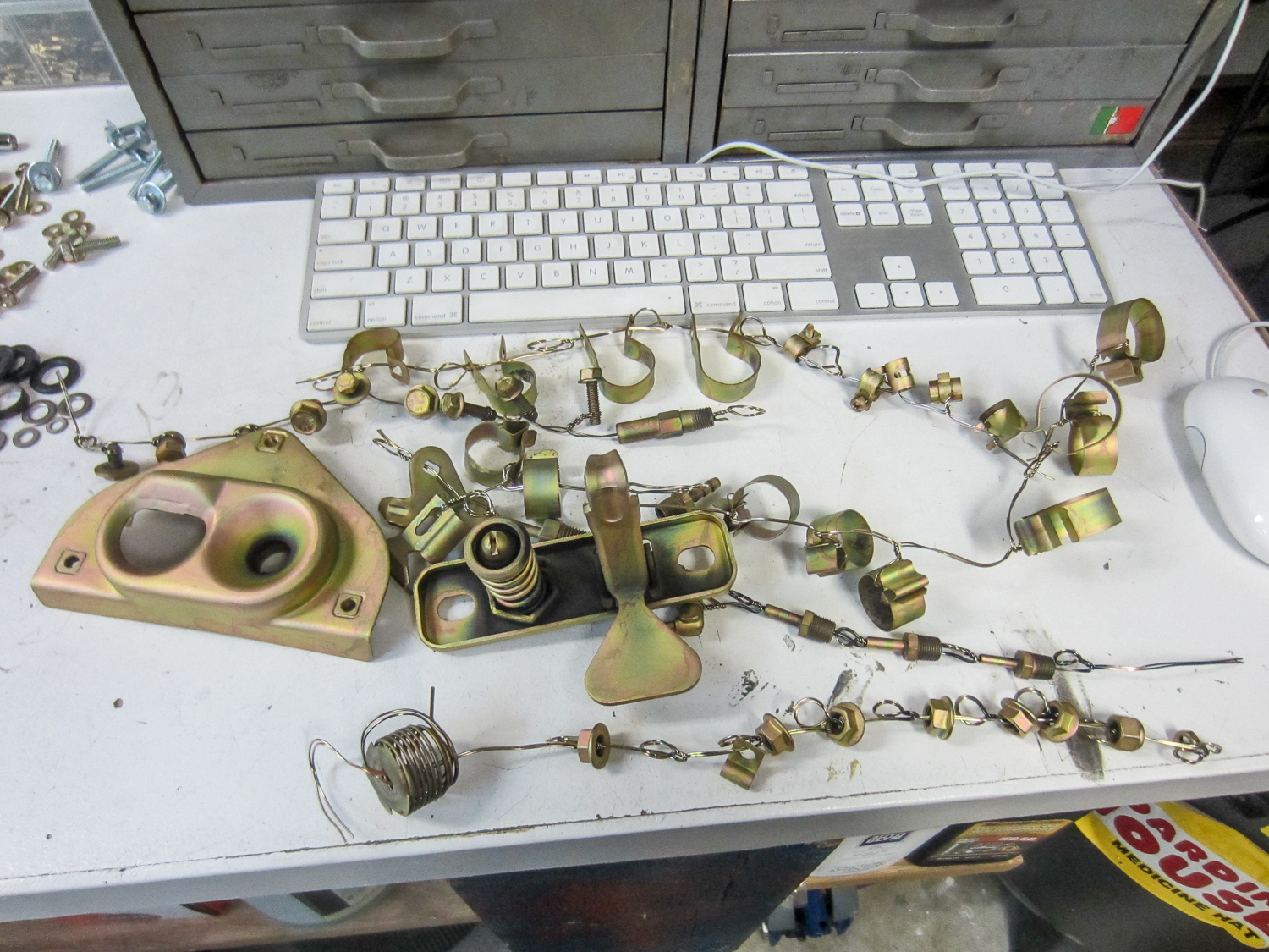

Well, the yellow zinc is back from Alberta Plating. Now I'm no expert, and perhaps my expectations were too high, but to me this doesn't look very good.
The rainbow effect is to be expected, but the dark black spots, particularly on the hood latch, really don't look right to me. Especially when you consider the photo on their website:
At the very least, the hood latch will be going back to get rid of the blackness. The rest are tolerable....just not very shiny, and quite dark. And they lost one bolt. Sigh.

Looking good Greg - they should redo that upper catch for sure. I'm not sure that it's all that bad given what it is. The originals may be a chromate or something other than just yellow zinc. I've seen a lot of colour variation in grade 8 bolts over the years. The only other option is to have them coated...but that means sending them to Calgary.
