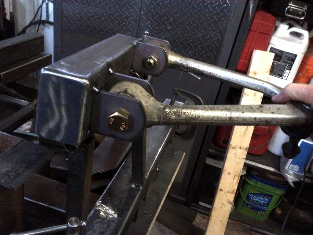

So now that most of that stuff is either done or I'm waiting for parts, I decided to get rolling on the suspension. The rear has to go in first before the front suspension comes off. So to recap, I'm using a MK3 Supra Turbo IRS (limited slip and stronger than the strongest dirt). It's terribly complicated and who wouldn't want more aluminum A-arms?
Here's the start point:
I built a frame to copy the suspension articulation points.
Then remove the jig from the frame (which did require cutting) and draw it in to the required width. Modify a few things so a subframe rail could actually be used in the jig.
I have started to fabricate the subframe to fit this all up under the 122. So I bolted the hub and upper A-arm onto a wheel and tossed it under the car.
From the inside...just enough clearance for the arm (the spring perches will have to be removed).
Beginnings of the subframe - looking OK so far. Space is too tight for the A-arm to get fancy curves, so a simple cut and welded 2 X 3 120 wall tube frame at the top will suffice.

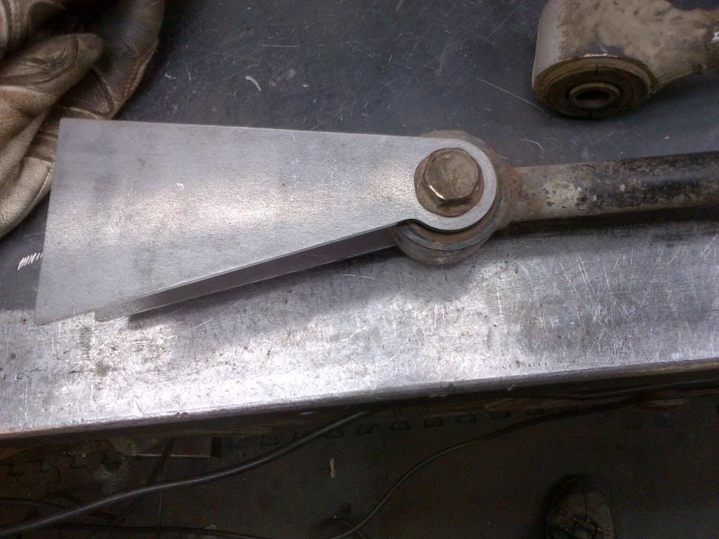

I had dreams of using Welder's Series weld on tabs for my suspension mounts, but as you can see here, there wasn't enough bearing area on the bushing. So I made my own - dammit.
They will work for this part as the crush sleeve is held and is proud of the bushing side. It's meant to flex.
The rear anti-dive is apparent in this shot - oh and my tabs were fabricated in a few minutes with the plasma (couldn't work without that tool). The tabs will be TIG'ed and then a cap applied to give more lateral support as a gusset to the outside just isn't going to work.
