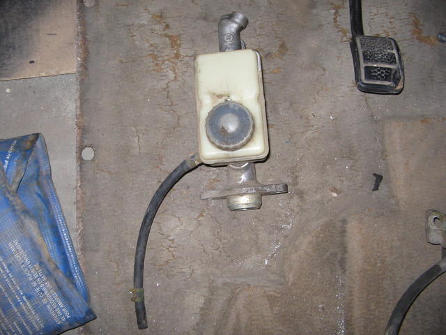

proper name??? (slave cylinder?)
i assume the actuator part goes to the tranny and the metal brake line looing piece goes to this...
master cylinder, where does it go? totally out to lunch here or...?

Next picture is certainly the slave cylinder. The other part is the master cylinder, which gets it's fluid from that extra port on the brake master cylinder reservoir. You don't need to replace the whole brake MC, just the reservoir if your current one doesn't have a nipple on the side that's capped off. The "funny looking character" is the clutch master cylinder - bolts right beside the brake master cylinder, using a couple holes in the firewall, undoubtably uncovered by the pedal cluster.
still shady on these workings...let me know if i am right
the brake fluid IS THE hydraulic fluid used for the clutch (instead of the cable design)
the rubber hose from the nipple on the reservoir goes to the slave cylinder metal brake line type part
clutch master cylindfer...still have no clue :lol:

No, the clutch master cylinder and the clutch slave cylinder connect using that brake line thingie. The clutch master cylinder gets fluid from the brake master cylinder reservoir using that plastic nipple on the clutch master cylinder body.
