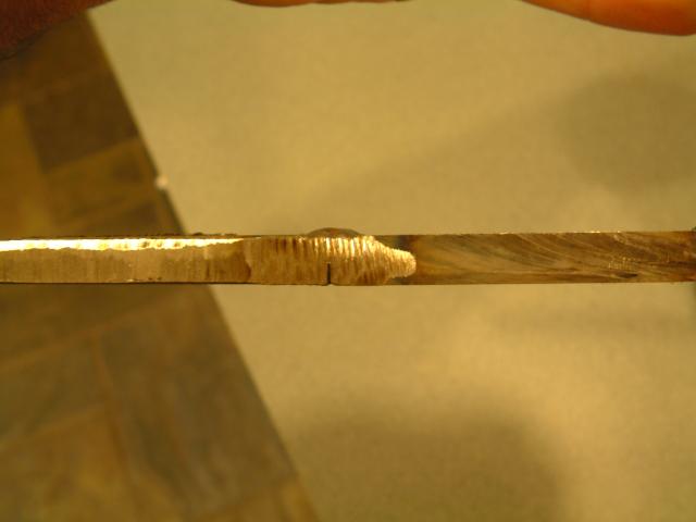

yeah, you're right, i'm not getting nearly enough heat into this thing with the little mig. I am using shielded wire, but am still figuring out this whole thing.
It's about this point i'm considering finishing the 220v wiring in the garage and hooking up this old beastly transformer type stick welder to get'er done.
I'll weld up a coupon and cut it apart for you guys today to get some more critique and see if i need more power.

here's a quick one, cut just off the centreline of the angle iron, single very slight bevel, one pass.
normally i've got a bevel and a pass on each side...
as you can see i'm only about 40% of the way in in the thickest part, so maybe a wider bevel in that area?
and pardon my ignorance, but i'm not familiar with what a "fish" weld is...
can you enlighten me?
Regardless, i think with a pass on each side and a bit healtheir bevel i can get some welds that i'd be happy with out of this.

Eric,
Those are COLD as hell. I dashed out the the garage and did up a coupon for you so you can see what I'm talking about (between periods of the hockey game - now that's dedication). Let's review - I'm working with a 120V Deca 135A machine - 8 out of 10 for wire speed, High 2 heat and 0.035" wire with Blue Shield gas.
These are on 3/8 plate steel.
Top of the bead
Back - showing no full penetration, more on this later.
Start - note that the penetration is shallow as there is no heat in the metal when you start welding. I'm still 1/2 way through. Also note there is no way to see where my weld starts and the metal begins - these are fused.
This is the end of the pass...not quite 100% but 99.9 will do for this weld. No way to tell where the bead is, also note the bead shape - flat without excess wire.
This is a fillet weld. You have to weave to get this shape - the idea is to fill the corner.
Cross section. Note the consistency of the weld as you look along it's length.
Heat affected zone - easy to see on the fillet, harder to see through the rust on the butt weld.
Make them look like this and you're golden.
