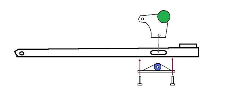

my goofy trailing arm plan using an energy suspension 9.9489 bushing.

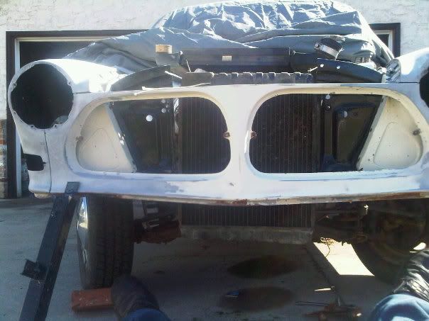

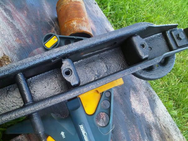

an idea for mounting the radiatior...

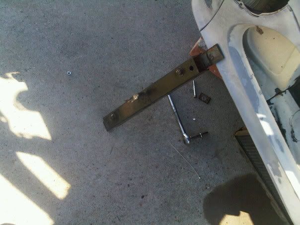

and the cross-bar between the frame rails... seems to have been in an accident sometime eh?
ah well, makes it easier to cut out/replace i guess.
any comments? ideas? this doesn't seem ideal to me.

PostPosted: Sun Aug 15, 2010 1:17 pm
haha nice! Looks like what i'm going to need to do!
i guess i'll move it as far back as i can towards the engine and see what i can fit in front of it...

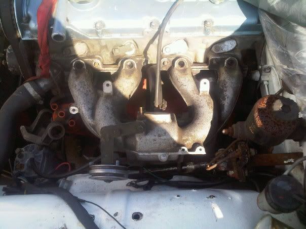

fitted a b230 intake... looks like it'll be a bit of a PITA because a bolt on the bottom TB block-off plate will hit the steering column. so i'm gonna toss it in the bbq after cleaning it and braze it on next weekend i'm down (2 weeks?)

wouldn't a kjet intake fit better?
PostPosted: Wed Aug 18, 2010 7:35 am
Doesn't look like it to me, Athal - the plenum would whomp the master cylinders. I think an old school B21FT intake might work though - points the throttle body in the right direction, anyway. Modify the K-jet holes to take LH injectors like I've done a few times, and you're set.
PostPosted: Wed Aug 18, 2010 11:06 am
ah, this head has k-jet holed jb welded with pennys/nickels in it :(
a b21ft intake i reckon would work the best.
Matt, do you have any info on mounting a fuel rail in the injector holes? it didn't seem to line up for me when i tried, and figuring out a mounting setup seemed fairly impossible.

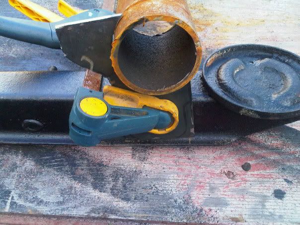

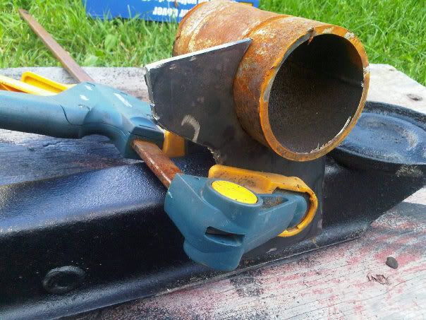

I'm going to hole-saw a 3" hole in this manifold, braze in a tube, and braze a TB flange on said tube.
