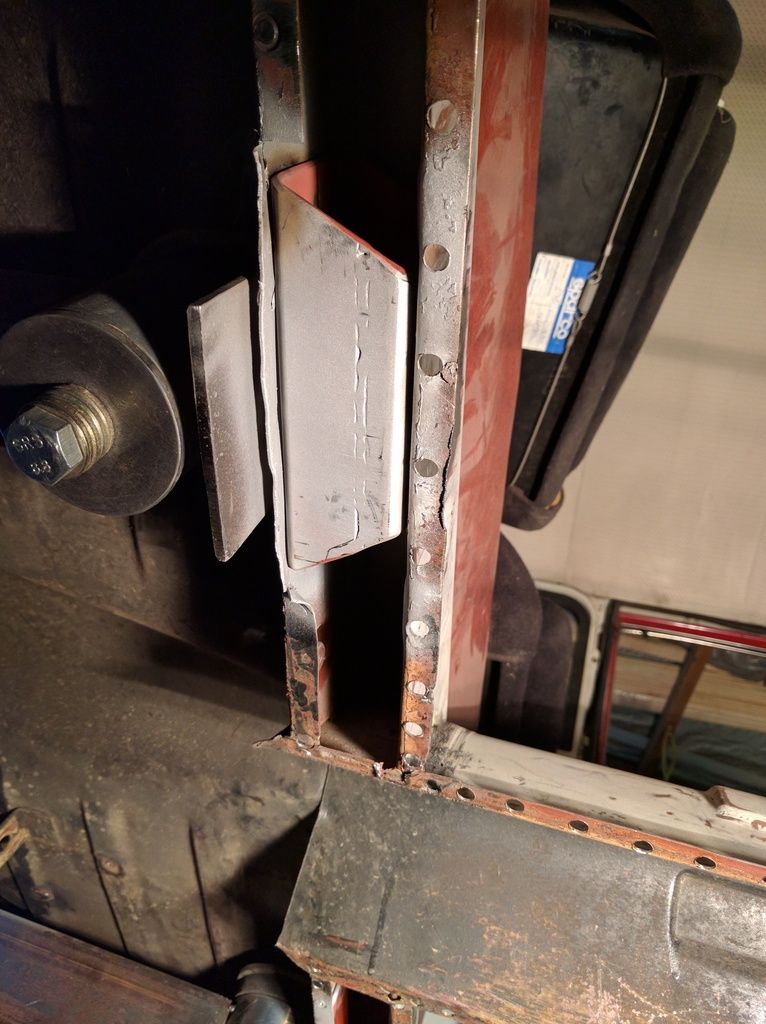

So I made some little sheet metal boxes. I don't have a box brake, so I make due.
Tap it with my sheet metal chisel - with a radius edge.
Sheet metal magic.
These will sit through the floor and hold the bracket level.
Chop a hole in the floor and find a way to level the pad.
That'll due. Note the angles needed to get things level.
Welded in.
Then I was freaked out because this might not be strong enough to hold the seat without a cross member. So I doubled up the base and joined it to the cross member. I will join it from the trans tunnel to the sill on the top side when I'm done working on the tunnel.
In the mean time - some plug welds.
Weld through primer to keep it rust free.
Jacked up from below and ready to weld.
Should be stiff enough when the top side is fixed.

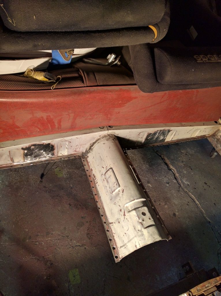

First start by looking at things and working out how the heck all this fits together. The floor pan is ONE gigantic pressing from the front to the rear cross member including the bottom of the trans tunnel. It's all ONE panel. So you've got to make some decisions on how it all comes out. I figured it was best to join the panel just on top of the front cross member and then take it all the way to the back where it originally went. This sounds great, but some finagling is required. I had to work out where I had to use the spot weld cutter to preserve a flange and where I could just drill (use cobalt or you won't get through the weld easily) - which is preferable to using the spot weld cutter. I figured it was OK to make a join at the bottom of the trans tunnel where it would not be noticeable and left the smallest area to seam weld.
The only problem was the transmission reinforcement loop...it is on top of the floor panel and the cross member. As it was one panel, I had to cut through various parts to get the parts of the old panel out so that the replacement looks flawless and is as strong as the original. So drill some holes.
Use the plasma to then cut out the panel and clean things up a bit. Surgical.
Remove various flanges and save parts to trace cut outs for the parking brake.
Here you can see the trans loop issue. It's released and the new panel can be fitted this week.
Nothing but fresh primer up under this box section. Happy to see that. Just have to clean up the flange and prime various areas (I will weld on that suspension bracket and reinforce it as I'm in there.

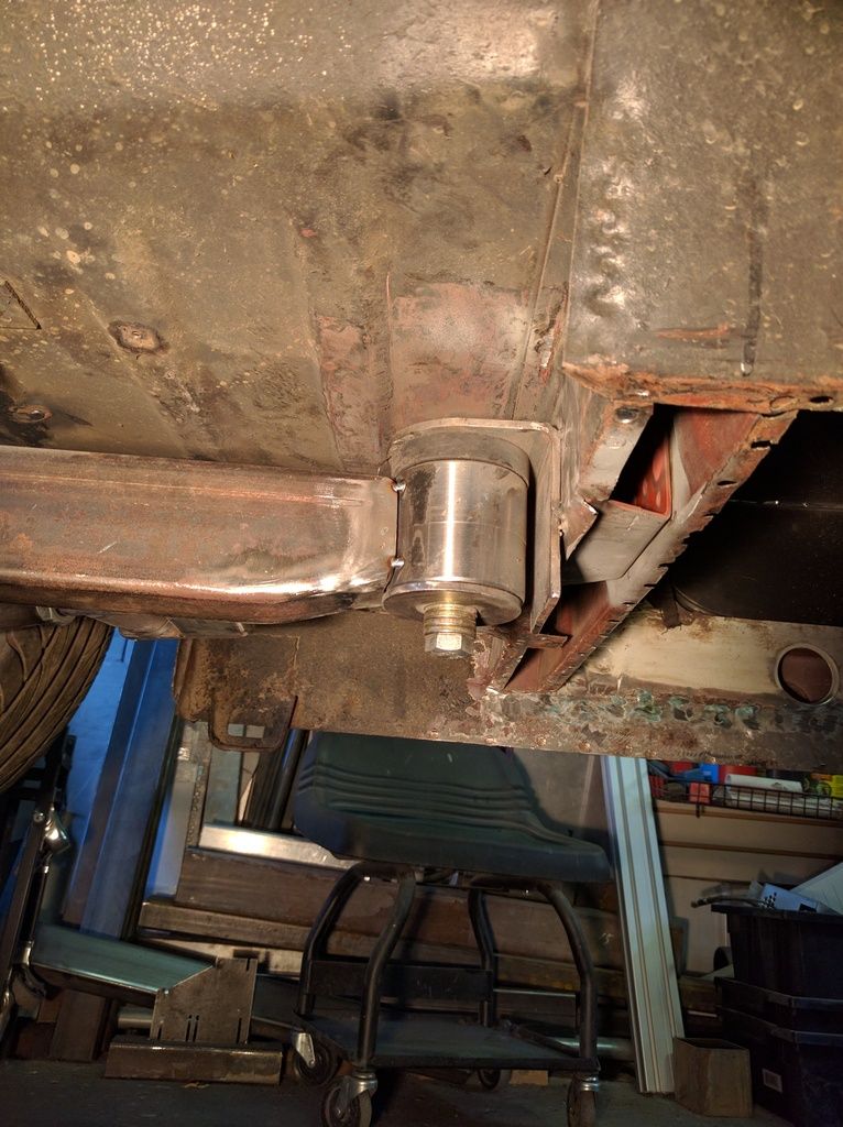

First up was getting the IRS subframe fixed up so that it was square to the car. It was set in the car a few years ago and we worked out that the drivers side front bushing was 1/8" too short. So it was always tacked out in space (the glories of MIG welding). I wanted that gone and fretted about it for years. How would I repair this and have it not look like poop and be strong. So I hacked the entire bushing arrangement off and carefully (in place mind you) welded the end of the tube from the inside out to ensure a strong joint with full material thickness. This had to be coped to refit the bushing. I got it all fixed up in one long evening. Welded back in place.
You'll note that there is a tube up inside the rear cross member now. I thought that would be best as I had it all apart anyway and it looked like it wanted to be reinforced. That tube was 2 X 3" 1/8" wall...but that wouldn't fit. So I had to section the tube and take 1/8" out of the width so it's now 1 7/8" X 3". Nothing is easy with this build. That took a night to work out and fabricate and prime.
Here it is all installed. That's weld through primer and the flange is flipped back down and welded up again. It's button welded on both sides. Not going anywhere.
